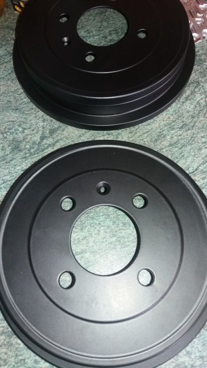

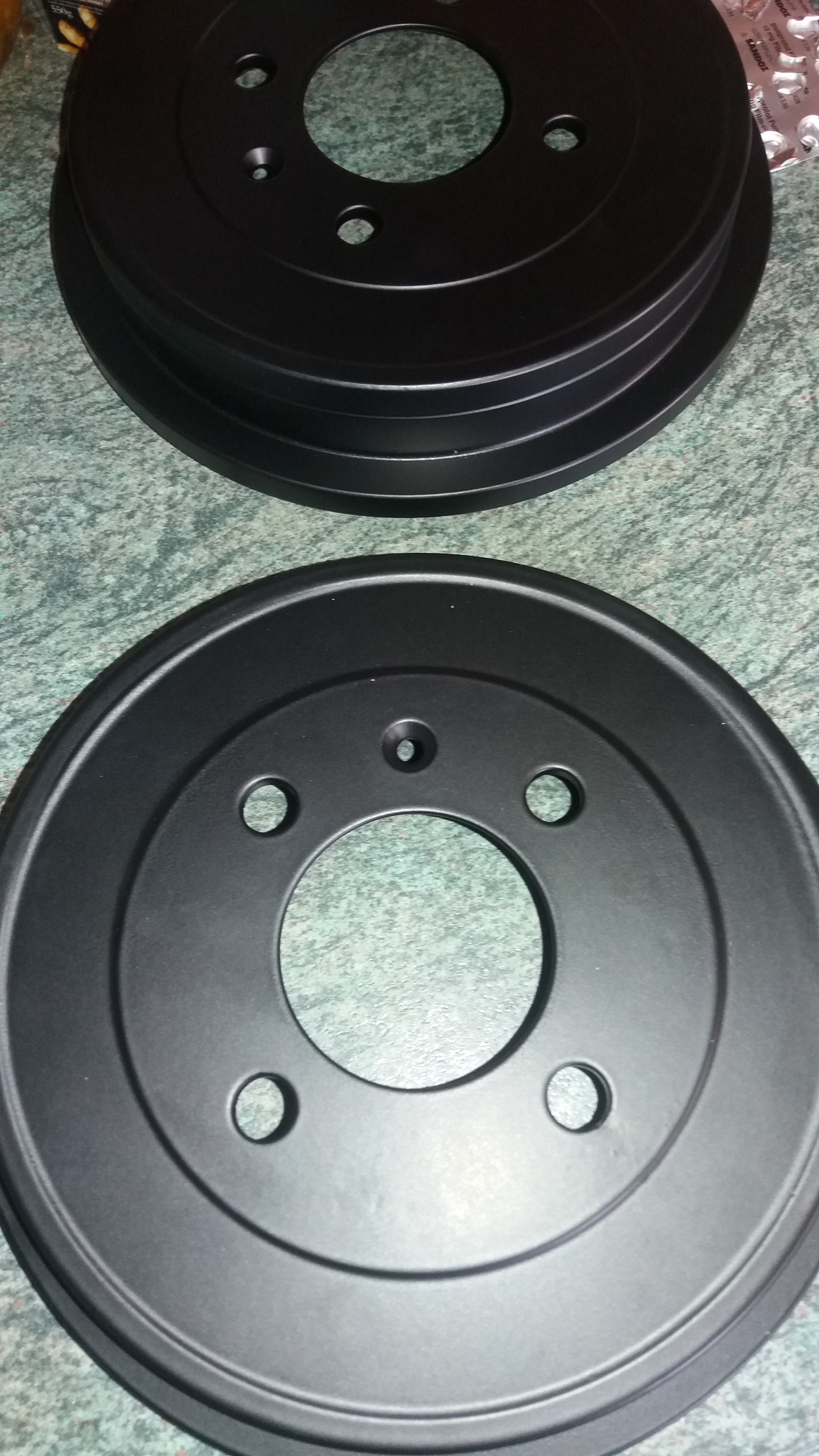

I had my rear brake drums powder coated ,only cost £25 ,  satin black , alloy wheels which are black, look's a lot tidier , Hammerite might work as the rear brakes dont get that hot , but powder coat is a safer bet
