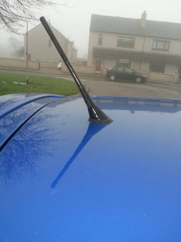

I fitted a new polo base and aerial looks a lot betterpost-110602-13966347961247_thumb.jpg

I didn't pay a penny for my aerial or base lol I think it looks better with the new polo one.
