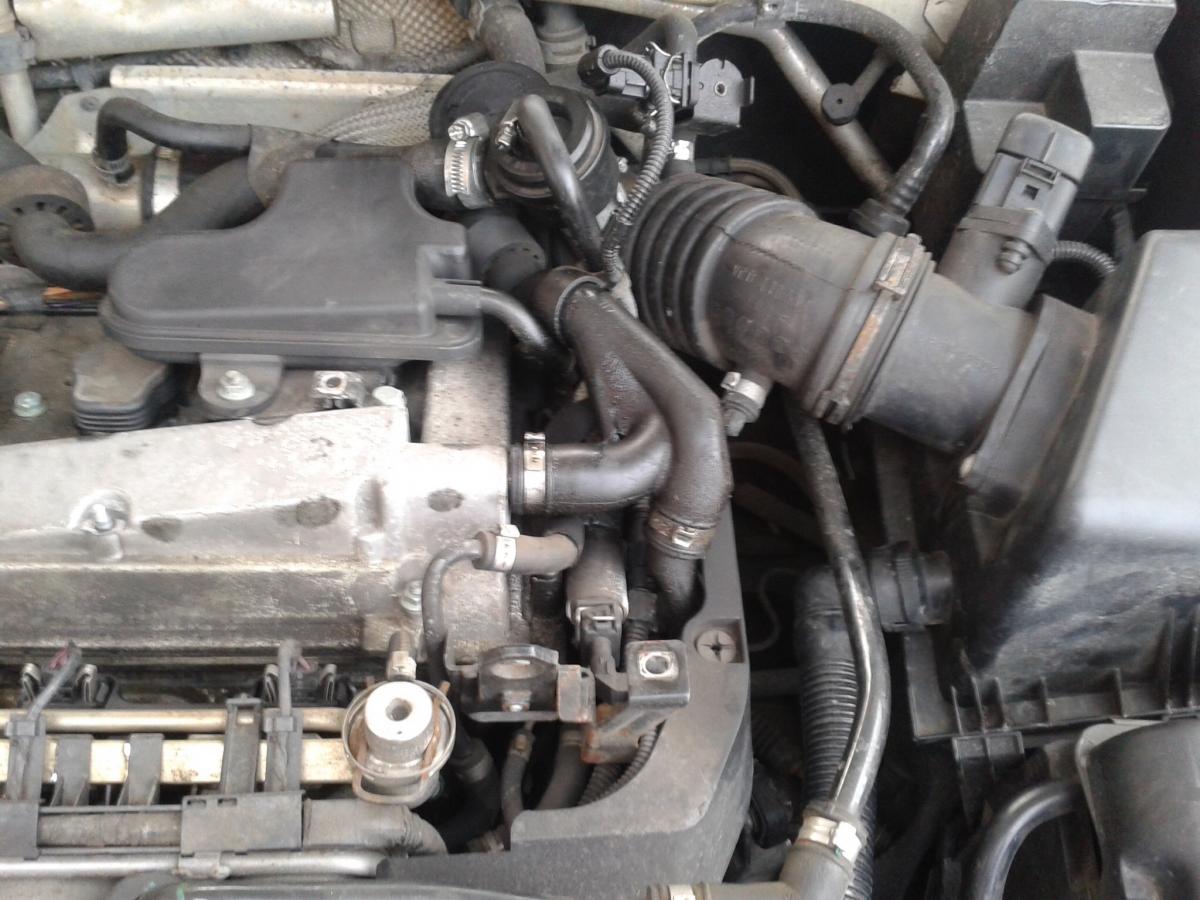

Would this split hose cause my idle problems and would this cause my engine management light to be on? Also what hose is this so I know what to ask for to get it replaced!!! Split is worse than it looks in picture.

Y boost / vacuume pipe. Mine didn't cause idle problems but did cause judder on acceleration. Got mine from GSF but silicon ones are available.
http://www.gsfcarparts.com/013vg0170?
Search s pipe to. More than likely to have split also.
