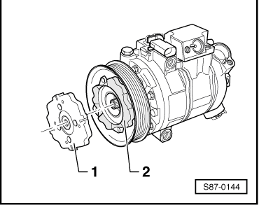

After my post yesterday, more reading on here i believe the sheer clutch in the compressor unit has sheered.
It doesn't look to be spinning with the engine running, and i can turn part 1 in the diagram, with out the belt moving.

It sounds like your compressor may well have seized forcing the shear clutch to do its job.

I was thinking it had seized, but i can still turn it by hand, do they only need to seize a little to make the clutch sheer if that makes sense?
