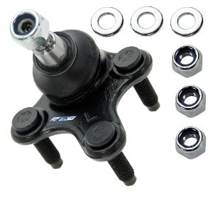

Started on the passenger side this evening, having bought a breaker bar and deep 16mm socket. I started to remove the nuts on the lower ball joint and two have sheered, so I have left the 3rd in place. I have started to look for a replacement lower ball joint and I can find 3 similar but different parts. One is, like the one currently fitted, with three bolts with flat heads running through it down and out of the bottom of the lower arm.

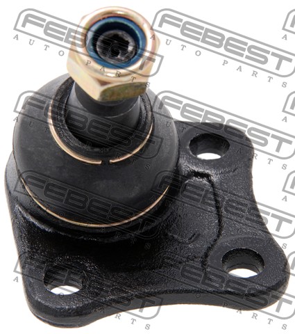

The other I have found simply has three holes , through which you presumably thread your own bolts and nuts

the first one looks like the correct part and the 3rd one is for an octavia mk1 / golf 4 and will not fit
beware the euro car parts website does not always give the correct part as mine snapped to when I changed my strut and was given the wrong part despite the part guys saying it was the correct part on the computer for my car and ended up going back again as it was similar to the part in your picture 3 and did not fit

I have bought the Febi Bilstein one from Andrew Pages, was only £22.58, and is exactly the same as the one on the car currently.

I managed to get a ratchet spanner in there and get the nut off but the spindle didn't want to come out of the hub. Then the three bolts on the underside didn't want to come out the lower arm either. So when I got my chisel in between the lower plate and the lower arm, as one side would wriggle free a little, the spindle released as I was whacking the chisel between the plate and the arm.  :whew:
New ball joint took some getting in to the lower arm too, the bolts were just a little out of the angle needed to slide in. So I put the nuts on, so as not to damage the threads, and a couple of taps with my shortie lump hammer and they slid straight in.
