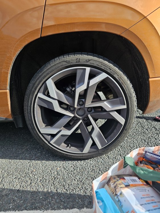

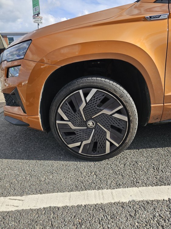

Just see that my 2023 skoda sportline karoq 19 inch wheels 19 inch.
Sagittarius I believe? One of the covers is missing. Unsure if has been missing long and wanted your take on whether it has been stolen or has just fell off due to bad clips or design flaws. See photo of good wheel and the trim removed. UK right hand drive. Passenger rear.
I think this is the missing piece?

One option is to remove the other three wheel covers, clean the wheels and leave them exposed. You can get a set of wheel centres, etc from a Škoda dealer.
I don't think they're fitted on the current model? When we looked at Sportline a couple of years ago, we were shown the dealer "Brand Manager's" car - he'd taken the covers off as he hated them so much!
