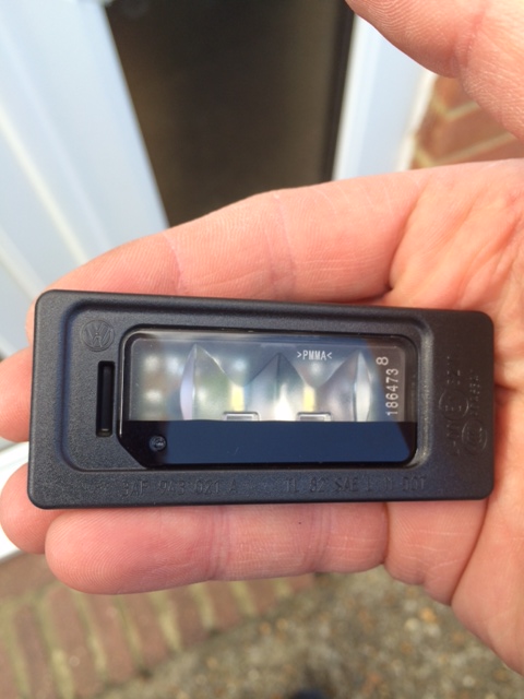

The VAG part number is 3AF 943 021A

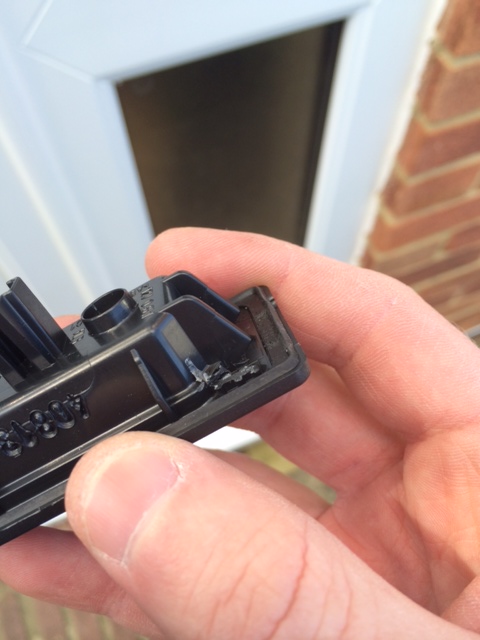

They aren't a perfect fit however, there are two plastic tabs on each LED unit that need to be removed.
Once these tabs have been removed, the units fit perfectly, they are nice and secure as one end is spring loaded like the original W5W units.
They have to be fitted in a specific way or they obviously won't work very well. They have lenses to direct the LED light evenly across the plate.

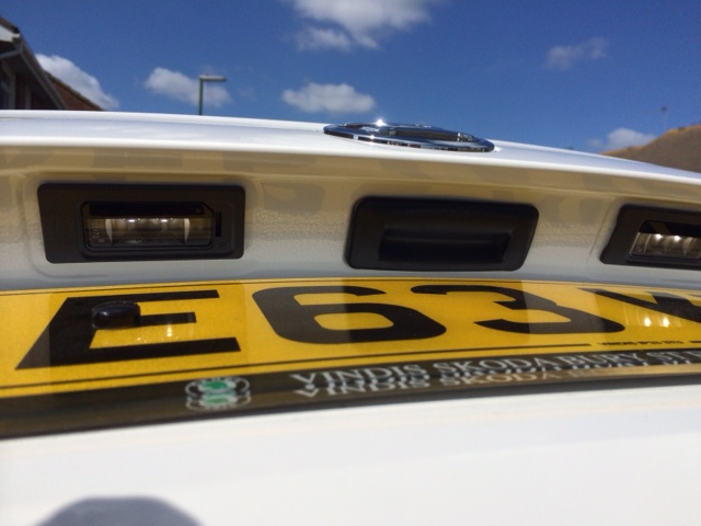

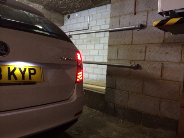

I fitted them in the sunshine this morning so had no idea how they'd perform. I parked in the underground car park and took a few pics of them in low light. The picture doesn't really do them justice but they do have the OEM look in real life. I'm pleased with the result.
