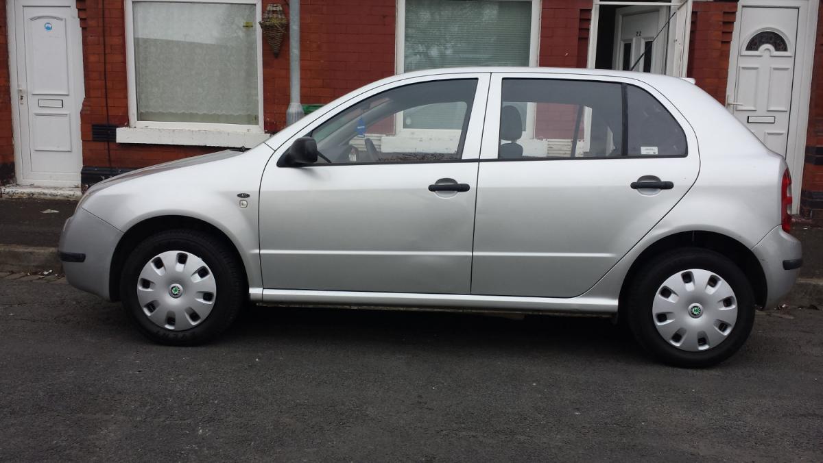

If they are the same size( 15") as mine would they straight fit onto my Fabia Classic 1.2,  2004 reg without any extra modifications?
Also, if they are bigger size i.e. 16" would they still fit?
Thanks
Yanni
P.S - Attached my car
