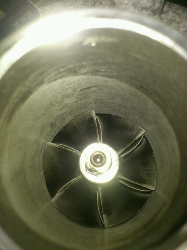

Felicia found the turbo has on the edge of each fin a bit of a dimple missing. hmmm
He's doing some other work on the car for the time being, but all boost pipes have been resealed but for now the radiator is in need of replacement :(
Not sure whether to get a new turbo for it pre-emptively
It needs removing and properly testing, you'll never be able to tell on internal wear to rule that out. Perfectly normal to have a bit of outer "wear".. remember how old it is and how many revolutions it's done over the years...runs into millions! Fin damage or if it's touching the sides means it needs changing. You need to see what the exhaust side looks like /wastegate.
Don't they have little nicks cut out of them for when it is being balanced?

Turbo failure really does bloody make you paranoid. I think I'll have a look around at other turbines to see if they too have those little bits of the fins missing.
84k on the clock - how long does KKK last usually (how long is a piece of string etc.) but yeh.

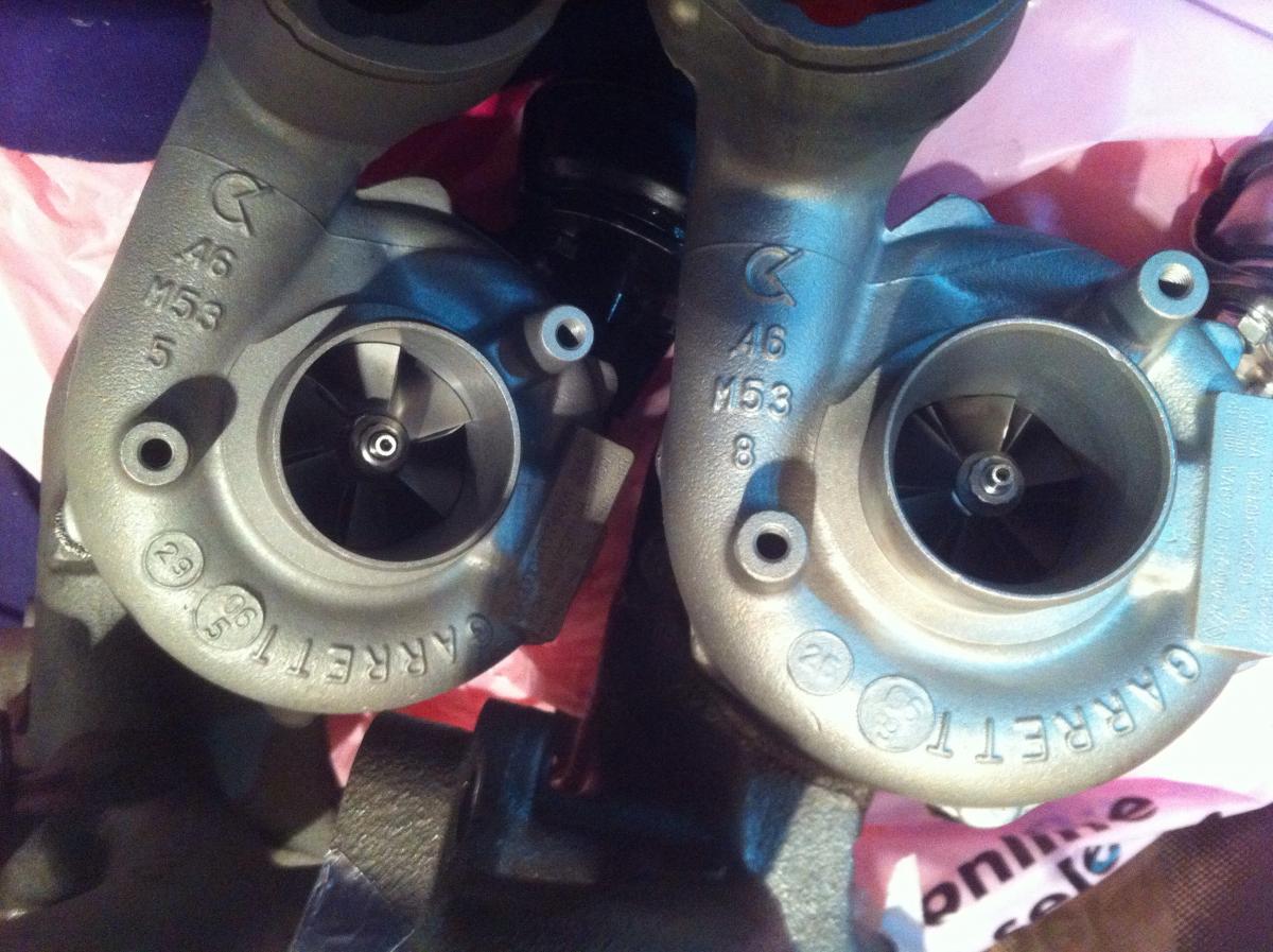

Question I face is hybrid http://www.turbodynamics.co.uk/shop/md446-stage-2-hybrid-turbo-for-vag-19tdi-130bhp-engines-p-2743.html or not. £300 difference from a standard unit, but I think I can get it cheaper via a trade user who tuned the car for me
These are abit different as they're both hybrids but the don't have the dimples missingpost-107345-0-74191600-1399043268_thumb.jpg
