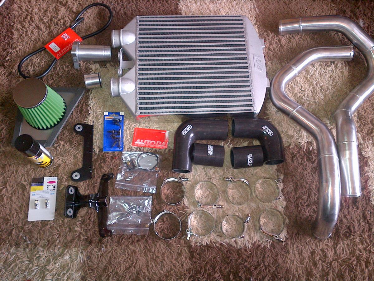

Seat sport cooler with a thicker core and darkside hard pipe kit £800 is what is cost me
Well that's what I got for 800 ignore the filter though only use paper ones

Biggest one you can get I think and its a twin pass cooler
Nothing wrong with that cone in the box filter, I would run one!

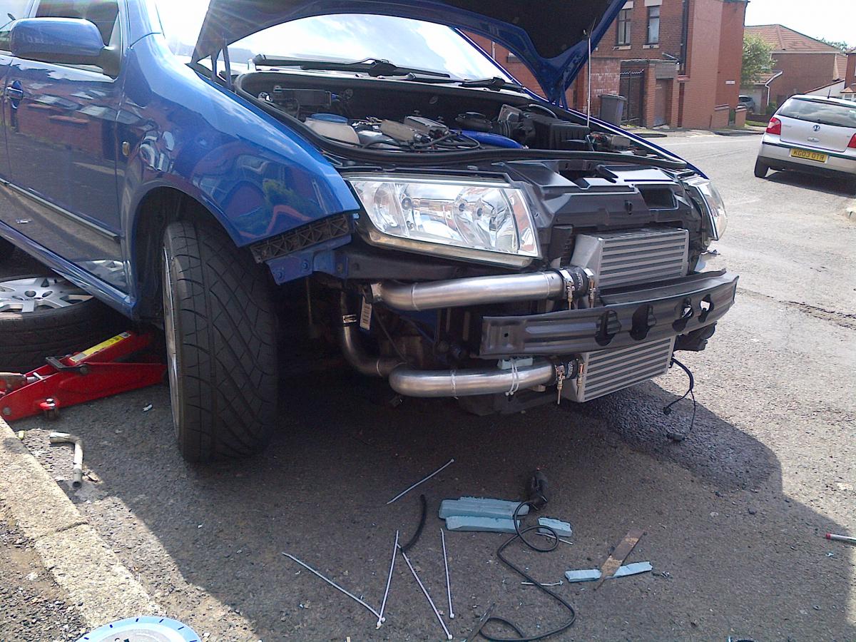

I got a jabba sport one as you can see in the picture and you could see straight through it, wouldn't get very good filtration and in the end all them fine bits of dirty getting through will kill the compressor wheel. I'm running 270 bhp on the standard box and standard filter no problem. But I am getting a costom air box made to house a Honda s200 cone paper element filter
Do you get no issue with sucking the standard paper filter through?
Seen a fair few deformed ones on here from people running big power!
I change the filer every few months. Think that happens when it's too dirty or wet

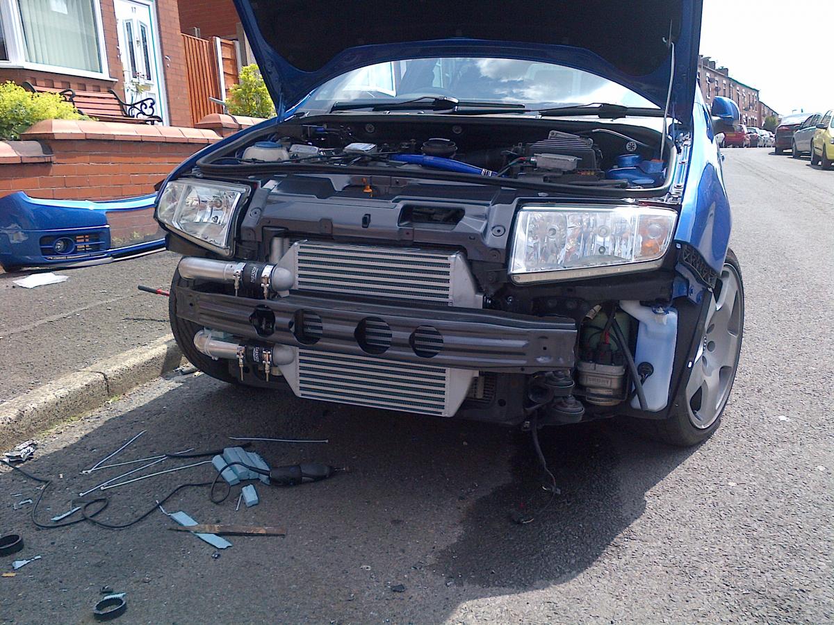

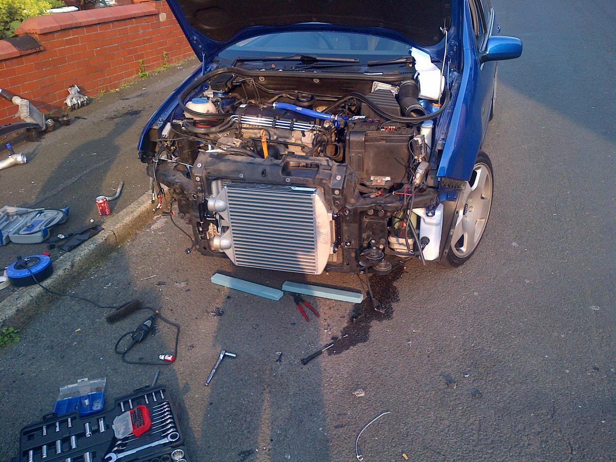

Took me a day to do but I did a few other thing egr and egr cooler delete boost gauge.... And I wasn't rushing
Yeah I have got one but going be running mine with darkside solid pipework ype9u9yh.jpg
To be fair mate any pipe work will work as long you make it up right and tighten it right I ran darkside solid pipe work before and at to have it alloy welded a few times due to hit rubbing and putting holes in it then because I had a shallow sump fitted and the pipework hangs be low me sump so was catching all the time so there problems with most pipework mate
