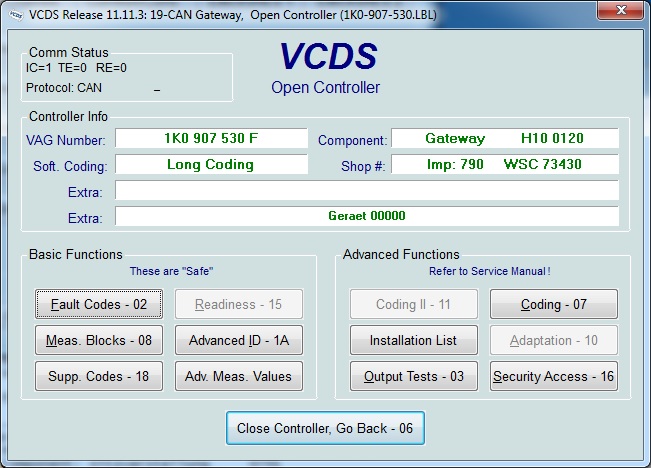

So everything is now here (Swing MP3 unit -Nav sized, New Fascia, Fakra adapter - dual to single, Alleged CAN gateway 1K0...AD) and so I fired up VCDS and found out I have an F revision gateway currently. Does anyone know of a guide to VCDS - CAN upgrades with screenshots, as I am not 100% sure of what I need to capture before swapping units.

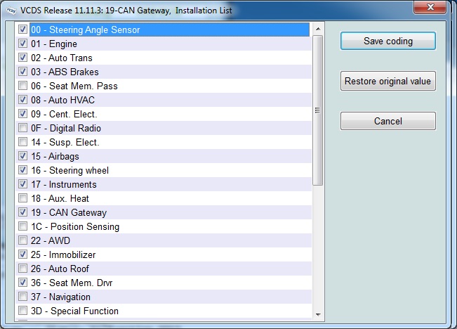

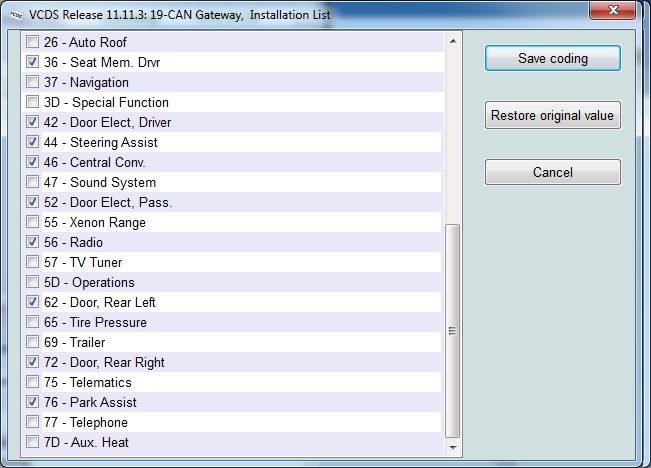

I have captured the following screenshots but think I need more possibly?

Pretty much all you need with newer gateways is a list of what controllers are installed, which you have.
There's little else to worry about.
Yeah the newer ones are done through the installation list, not coding.
Oh and a couple of the controller numbers are different. (IIRC steering angle sensor is no longer 00)
If you're lucky, the gateway will be behind the glovebox. If not, you'll have to do some dis-assembley under the bonnet, but it doesn't take long and is really easy.
Cheers Guys!
So basically I just need to re-tick the same options (being aware that some may have different number vales) and that is it!?!? Wow easier than I thought :)

All done! It appears to have been as easy (relatively) as suggested. I removed the glovebox (diconnected the air hose and the light) and tipped it on its side to avoid having to disconnect the airbag switch. Immediately found the canbus gateway on its bracket so I then unclipped it and undid the connector. Next bit was to connect the new gateway and power up the system (plug in VCDS) and look at what was in it. Turns out it is off a VW and was as advertised a 1K0...AD unit :)
I then checked through the options (only about three or four options needed adding) and coded the module. Autoscan and clear faults, all done! Test radio (entered code received from ebay) and relief all round as everything works first time.
