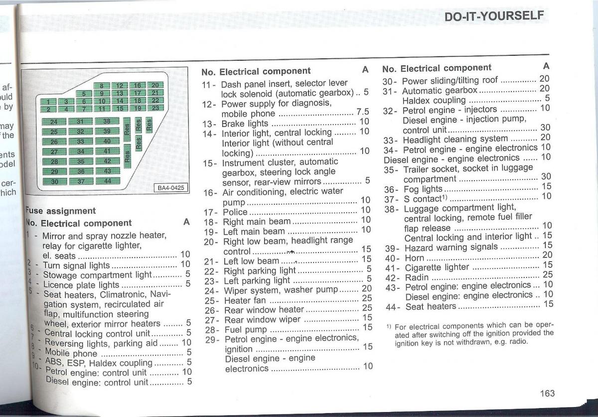

Ok, so i went to check the fuse and guess what... I couldn't find it.
I check all the fuses just in case and all of them are fine. However I still wanted to know which one it is, so opened Haynes manual and Skoda manual, but I could not find the fuse for airbags.
Anyone knows which one it is?
I am fairly certain it is fuse number 9 I believe.
Hi I've scanned the page with fuses.
I can't see it anywhere.
No 9 is ABS,ESP, Haldex coupling no mentioning of an airbag
