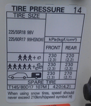

VAG need to do what other manufacturers do and actually provide the minimums for the car. This is the sticker off my (not particularly slow) Subaru. Tyre sizes along with minimum load and speed ratings, with a clearly displayed alternative for winter tyres. No worrying about what might or might not be suitable.
Our other car is a different brand and has a similar plate again with minimum speed and load ratings.
Our other car is a different brand and has a similar plate.
My O3 estate has something just like that inside the fuel flap though not sure it goes down to speed rating detail.
