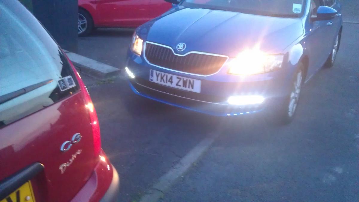

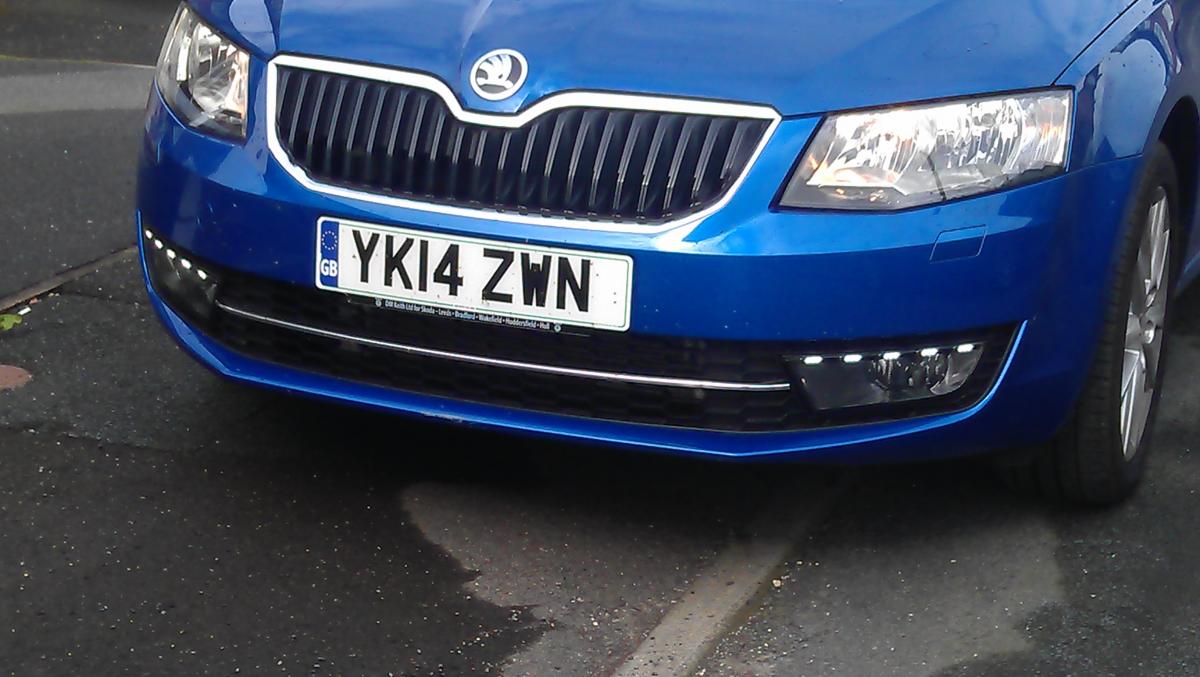

PS Spenford let's see a pic of your after market LED DRLs?

Where did you get you DRL's, what is the spec, cost etc. Were they east to fit, any canbus errors etc
I would really like to replace the standard DRL bulbs with led, but I have mostly read that you get errors with them.
There must be someone on here that has done this sucessfully?
On the octavia 3 you can correctly code for led bulbs in you fogs or DRL's, So no bulb errors.
I have LEDs in my 4 fog lights and they ping up an error on the dash - quick VCDS session and the error light is gone :-)
Aftermarket LED strip connected to ignition on live....easy and no errors.
Very nice. Just got my Elegance a few weeks ago here in Oz and would like some nice LED DRL's. Links to source and install guide would be much appreciated
Ebay for the led strip..tinted fogs and then just stuck on leds.As for wiring, wired into lights, if you do it right they stay on when ignition on, just usevoltage tester to find permanet live when ignition is on
