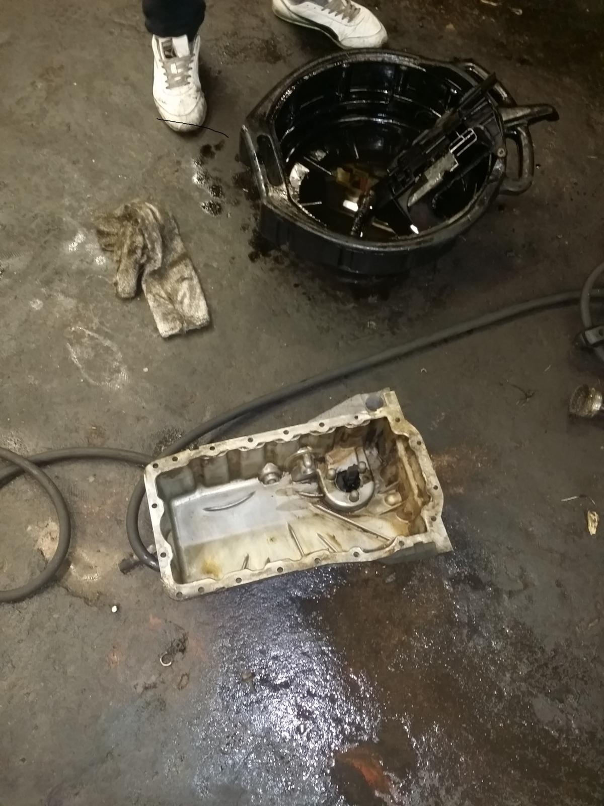

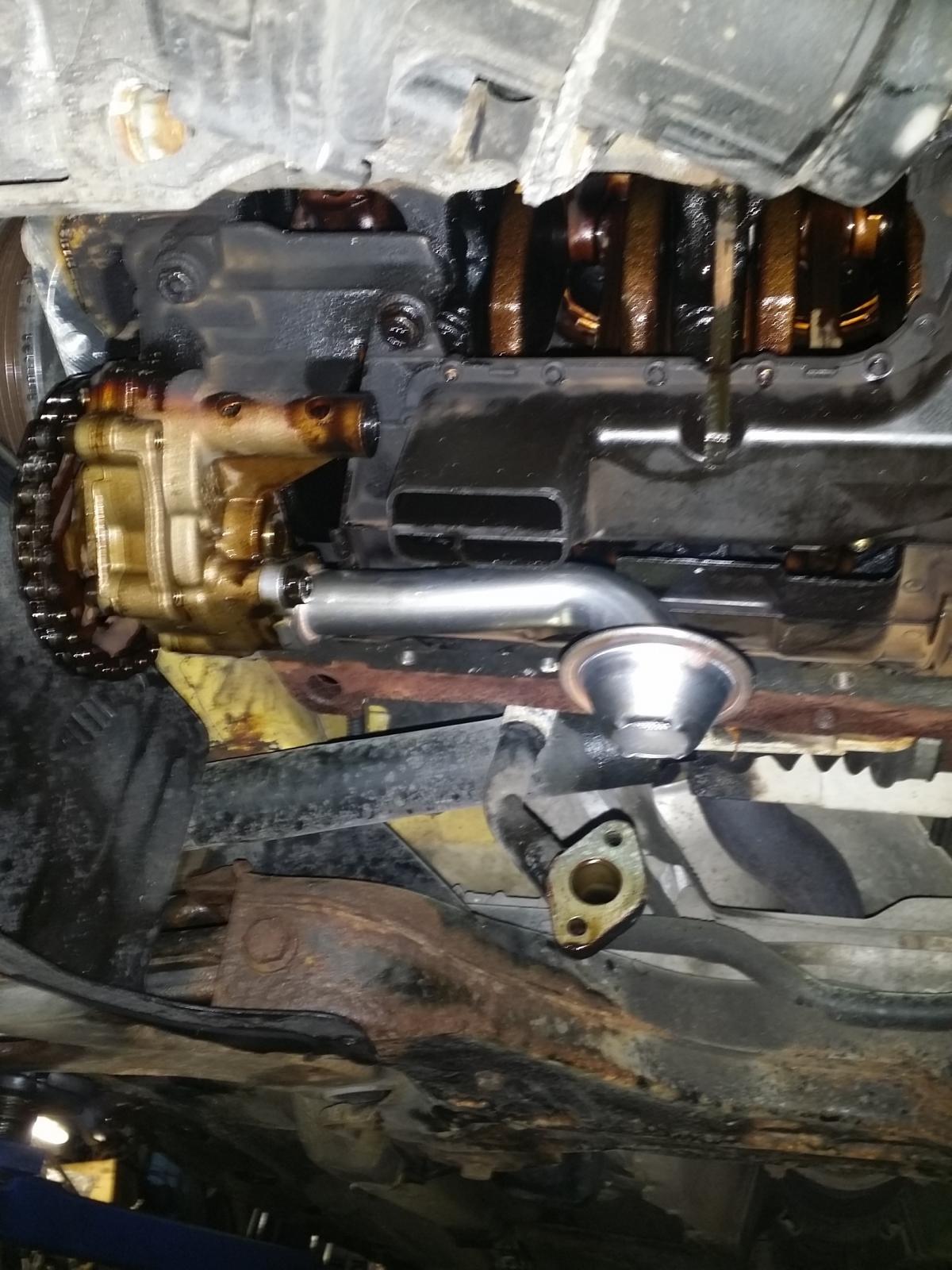

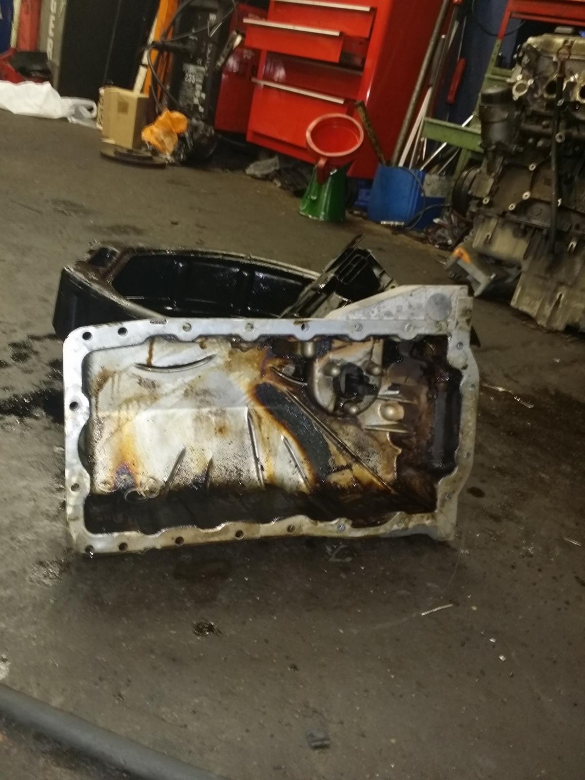

some pictures

Yes buddy exactly the same but iir mine sounded rough it was a long drive up to the dealer I can tell you! But I think red oil light is low pressure yellow is low oil level I think? How many miles has yours covered?

You could do an oil pressure test first. That's what the main Skoda dealer did with mine before replacing the pump. Mine had only done 90k when mine failed.

Then my advise do not drive it at high revs as you will kill it. The red light is telling you you have poor pressure. Trust me it will make a noise soon if you continue to risk driving like that. It may not be pump. My guess is your car has had poor service schedules if the pickup pipe was blocked bad. You should of also replaced or flushed out the oil return pipes like to turbo etc as I garrantee they will be blocked or partially blocked which is reducing oil flow. That will cause red light as it will think pressure is not correct due to poor flow. And poor flow will mean metal components are not getting lubricated properly and guess what will happen when your turbo is running dry and getting even hotter......
