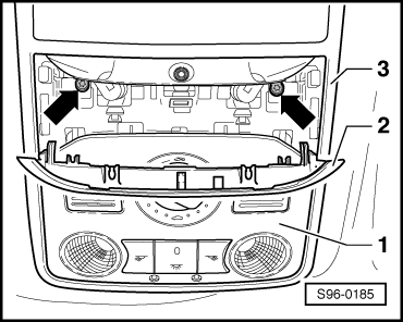

Can anyone advise as to how to replace bulbs in overhead consule of a 2013 L&K please?
If I know VAG group then you have to prise off the clear cover with a screwdriver better still make up a plastic priser for this job.
I think I did mine by this method.
You have to first remove the area that may be the sunglass holder by using a thin blade to unclip it, then unscrew the next area, then you can unclip the light area to get to the bulbs.
The lenses are NOT removable.
Thanks  -- tried to prise glasses holder but reluctant to use much force so no progress. Can you say where exactly to apply thin blade?
Loosen the cover -2- out of the catches using the disassembly wedge -3409- and tilt out towards the bottom. –  Unscrew screws -arrows- and tilt out the interior light -1- and suspend it from the installation frame -3-. –  Disconnect plug.
Installation is carried out in the reverse order.
Thank you.  Will try again tomorrow.
