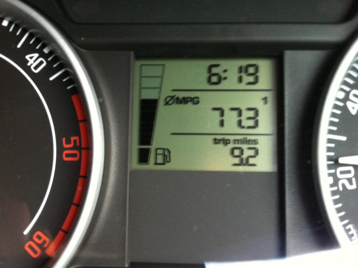

i would say your economy is a little low, I see 60mpg from daily commute, and nearer 70mpg on a steady motorway run, and if you try real hard ive achieved 77.3mpg on a 50 mile b-road drive! :clap:
You really have got that high mpg,is that off the onboard read out the highest I seen on mine is about 55mpg.
Cheers
Yes it is off the on-Board read out, once you get a feel for these engines you can get the mpg up, people assume they dont operate at low revs but they do,they have the torque, more than happily, Example: as long as your light on the throttle you can ease along at 25-30mph in 4th, or, 40mph in 5th.
the long term memory (no.2) has been running for 42hrs and over 1300 miles and its showing 66.2mpg.
