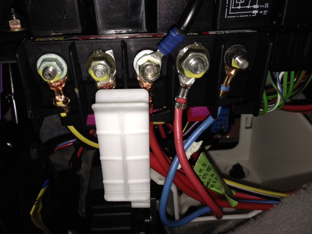

I'm looking for an earth point near the fusebox/pedals
Hi everybody,
I'm looking for a decent earth point on my 55 plate Mk1 VRS - I intend on hard-wiring in my Valentine One radar detector so I don't have to use the cigarette lighter socket.
I've only had the car for a week or so and I'm new to the layout of everything - especially the wiring!
I've attached a photo of what I've discovered so far - none of which look like earth points to me.
The hard-wiring kit consists of an 'add-a-circuit' which slots into the fuse box and then an earth wire to complete the circuit.
Any help/advice/pointers would be much appreciated!
Thanks in advance :)
Think theres a earth point to the right of those on the chassis. Might be under the carpet
OK thanks for that, I'll take a look :)
Thanks for that link - I saw it during my initial forum search, but it's just getting to it...  It was a real struggle to take the photo I posted, so getting to that domed nut is going to be interesting.

That picture you took, that plastic fuse box is bolted to a steel plate. That steel plate is your earth
Just take the lower trim off only a couple of torx and gives loads of room and access to the domed nut for the earth point.
Thanks guys - that's what I ended up doing :)  I've attached the earth cable to the bolt holding the fuse/relay box to the steel plate - sorted!
