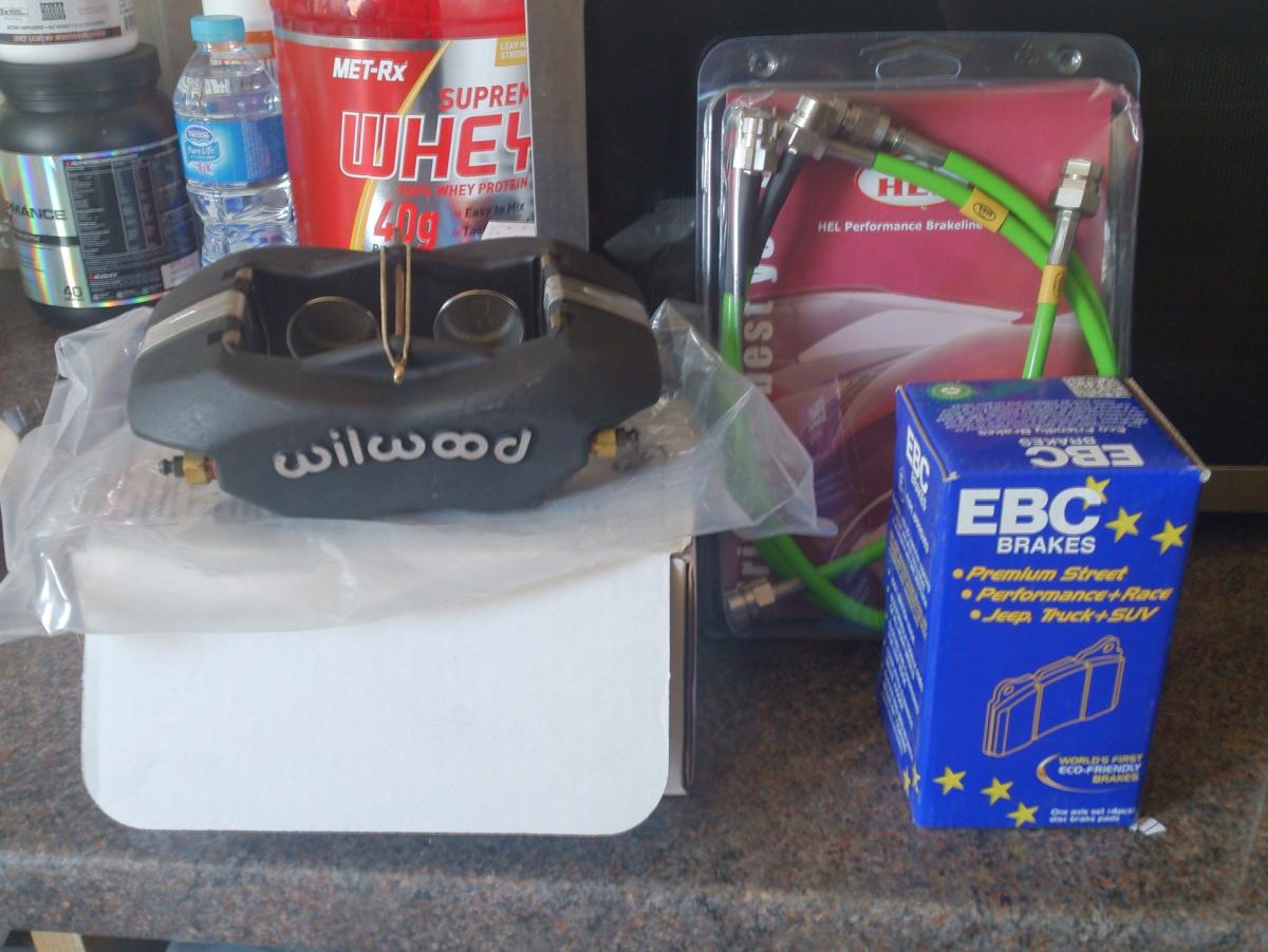

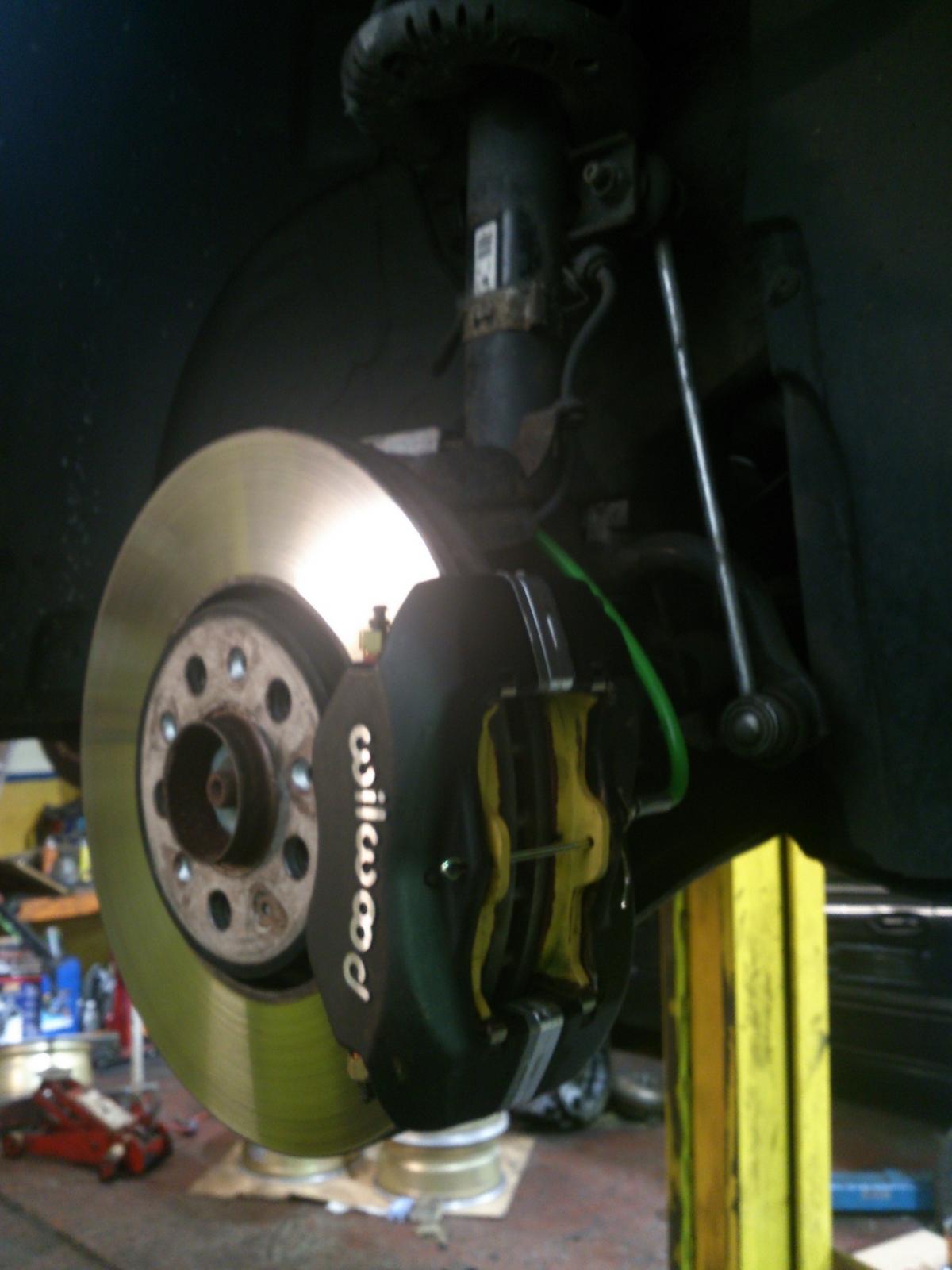

Hi everyone as promised.... My brake upgrade
  • Wilwood 4 pot Dynalite callipers with custom carriers (for standard sized rims)
  • EBC Yellow stuff pads
  • Racing green HEL brake lines

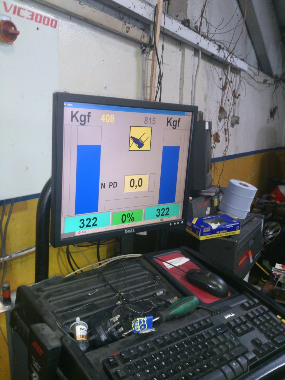

Braking force has dramatically increased, reading 322kgf registered per wheel, perfect balance and very strong bite and that aint even bedded in yet!

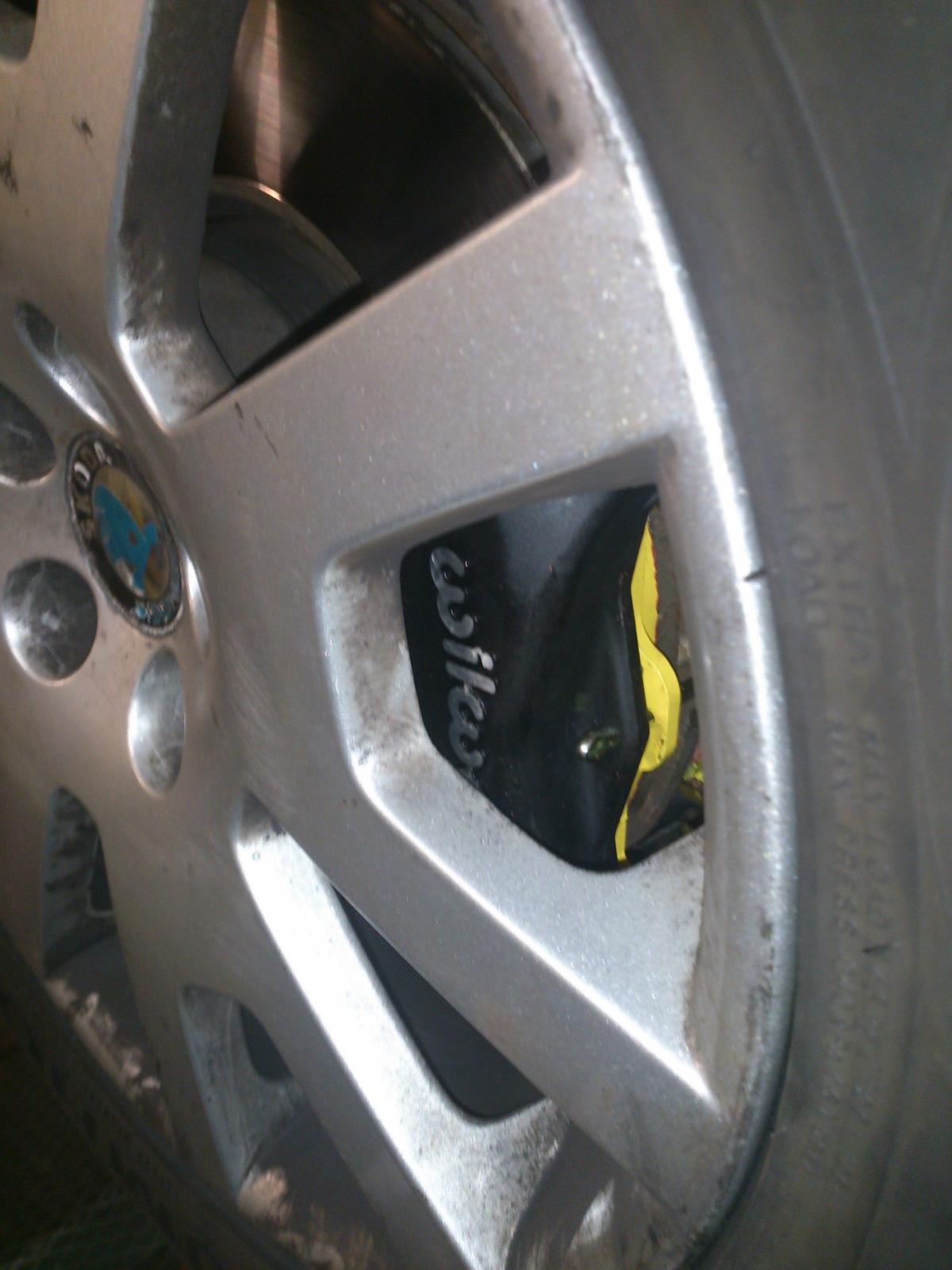

They look the business under the wheels  :D
what do ya think?

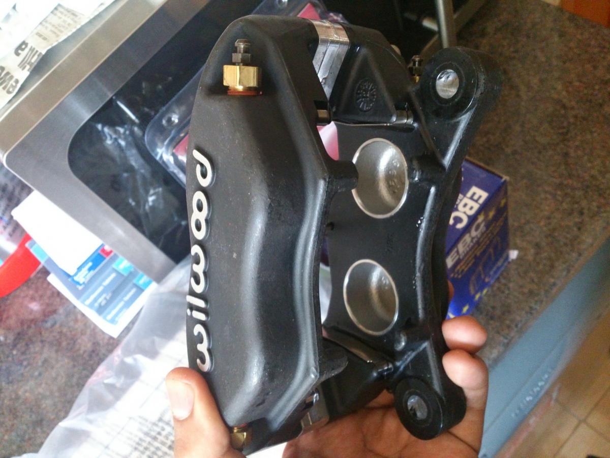

These callipers are for standard discs and incredibly light

I went wilwood route as these were already bought before for my celica t sport, so Big thanks to vrs Joe for lending me his hub to get custom brackets fabricated up :)

Quite a lot of inner disk not being used though, do they do a slighter bigger caliper that would use the complete face of disk?
How have the brackets been made, billet alloy?

I believe they are ally brackets very sturdy...
Even with the bigger callipers there will be some disc untouched by the pads, I was given the reason but for the love of me I can't remember!
I believe the pads are longer in length though, I will have to paint untouched area to prevent rust build up or if getting new discs go for zinc plated mtec discs

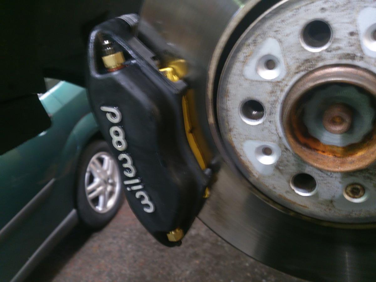

Shame there is no dust seals on these, remove and clean every 6 months and even more in winter

The dust seals (or lack of them) would concern me, but no doubt they look better and will perform better than the standard OE 288mm set up
The dynalites are meant for smaller lighter cars with smaller discs iirc. Still looks good though!

A combination of fresh brake fluid good pads and braided hoses contributes to much better braking, these forged dynalites are very light, half the weight if not less than the oem setup,
In Terms of no dust boots, I believe it dint have any as under heavy braking the rubber would swell n lose its integrity... it would need occasional brake cleaner + light scrub with toothbrush no biggie ;)
