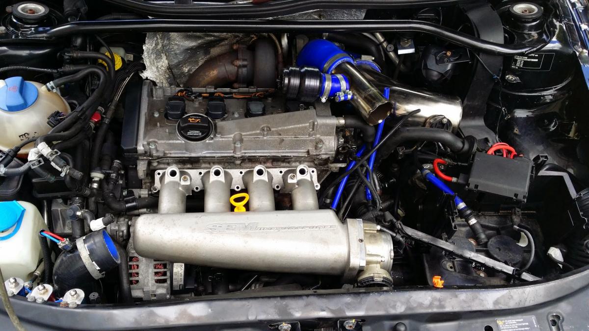

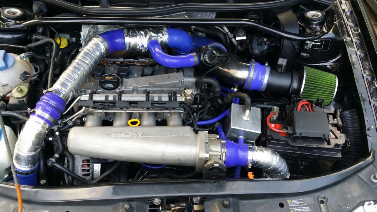

Finally fitting my SEM..
So took the octy off the road now..
Finally fitting the SEM intake..
Only encountered 1 problem ..as I have 750cc injectors so slightly longer,and the rail needs shimming.
Just need to sort the AIT and TB wires to be slightly longer.
Need to sort the pipework,and re route the WMI.
Can't wait to get it going again...it's only been 9 days
Will post my findings once it's been fitted..will obviously need mapping again,
So I've finally fitted it...only to realise the MOT is now due...great.
Next stop MOT..then Bills to be mapped again,,
Can't wait,TBH.
Are you smaller diameter pipework there between the FMIC & Intake Mani than leading upto the FMIC ?
Hi bud it's all 63mm pipe work..leading up to the RS4 throttle body.
