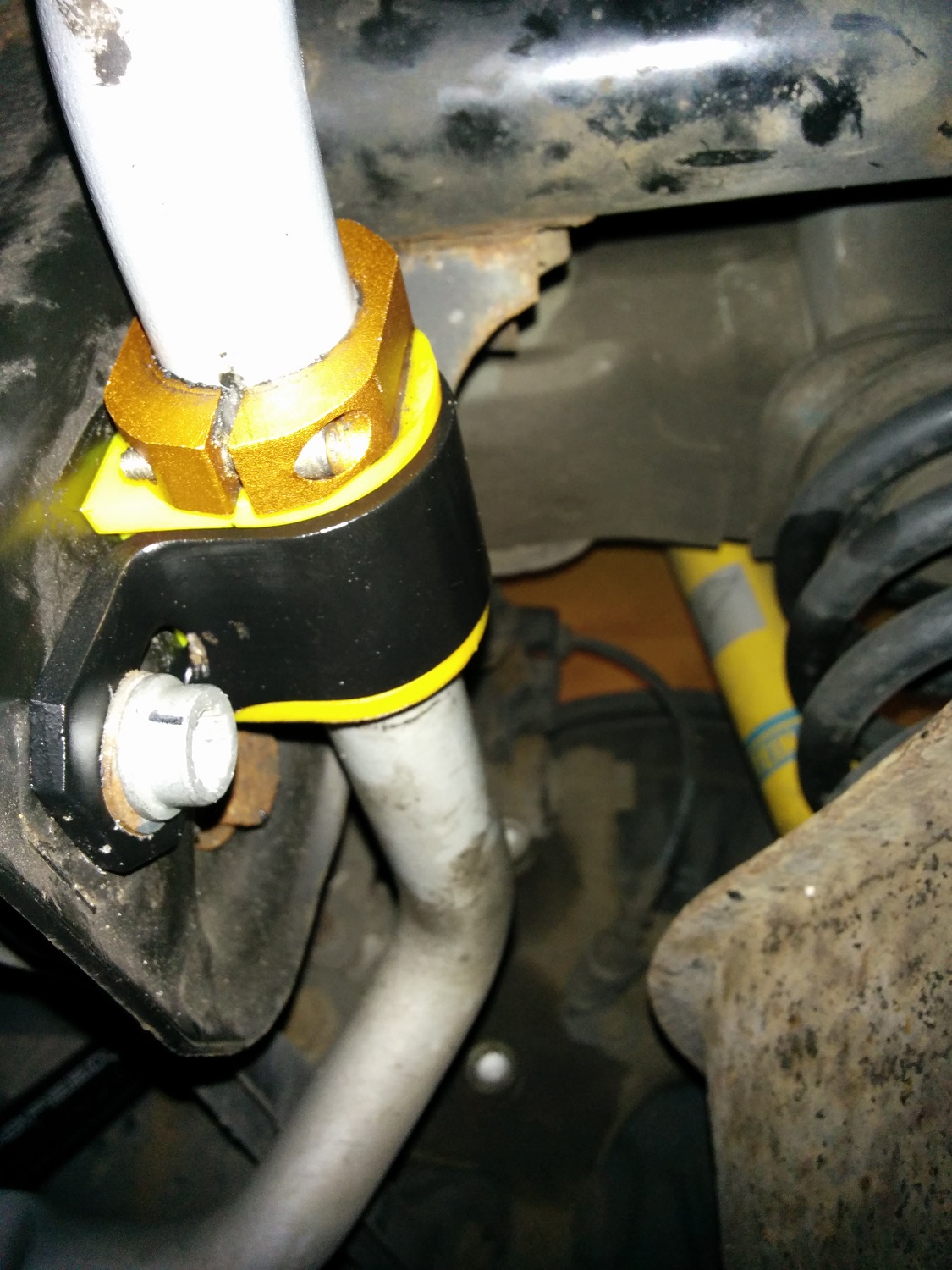

It has taken me a while to get around to properly sorting this out. I narrowed it down to the RARB bushings. On closer inspection and removal of the bushings there was little to no grease left in them so degreased and cleaned them up re-lubricated them with silicone grease.

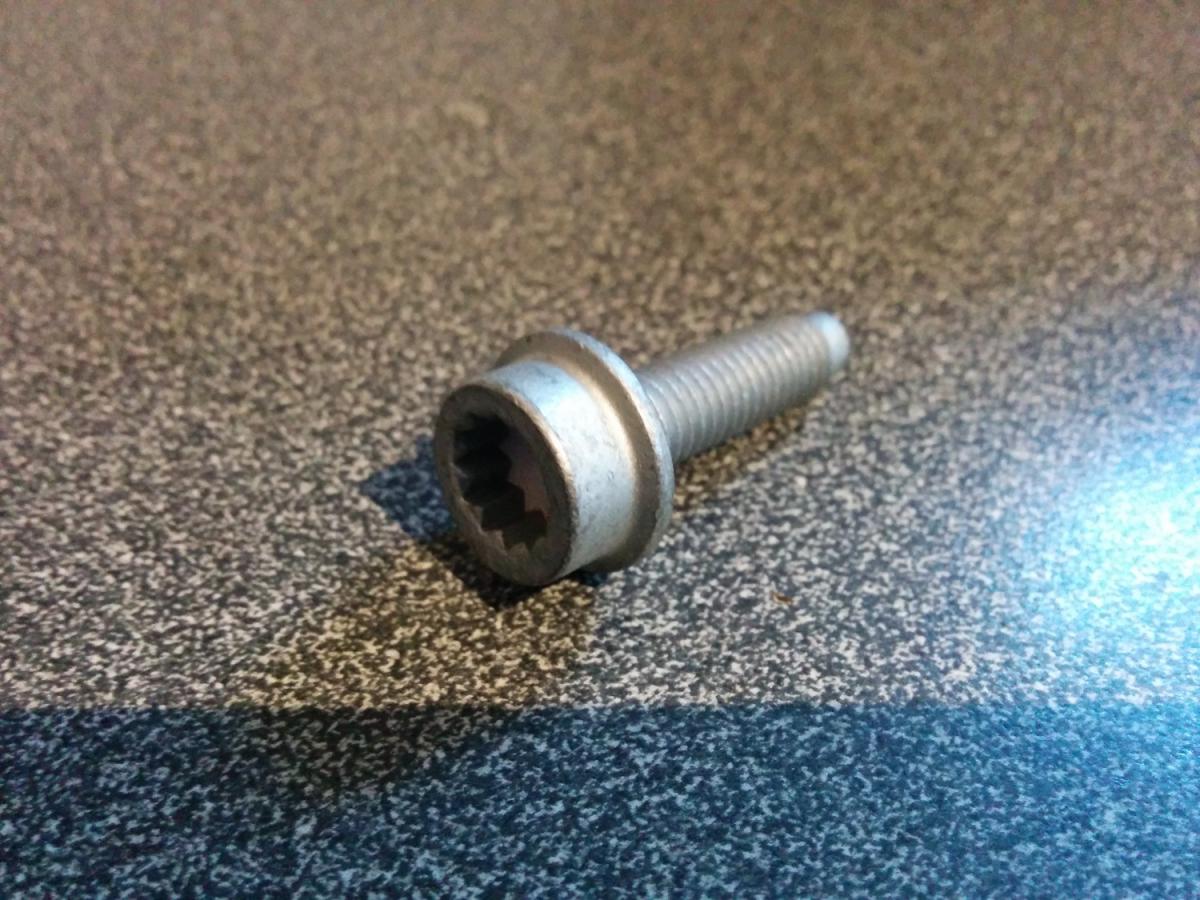

I also used new stretch bolts for the clamps (P/N: N 106 447 01)

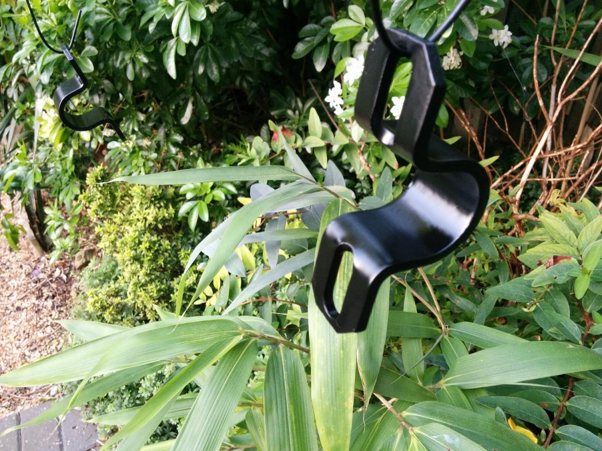

There was quite a lot of surface rust on the clamps so I gave them a clean up with the dremel and wire brush then gave them a few coats of mat black
The finished job.
