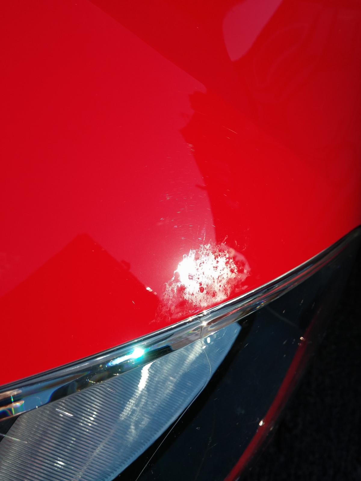

Radioactive bird **** :(
Ive discovered a recent bird-poo incident that has marked the paintwork..
Any suggestions? ive tried to clay the area but that hasn't helped..
Will most likely need a good machine polish to shift it and remove clear coat damage mate.
A good cutting polish should sort it.  Looks more cloudy than actually "eaten" in to the paint. :)
If by hand, I'd be tempted to rub in some kind of "paint restorer" polish.

Sorry to see this Col
As said...It will polish out...I'm sure
