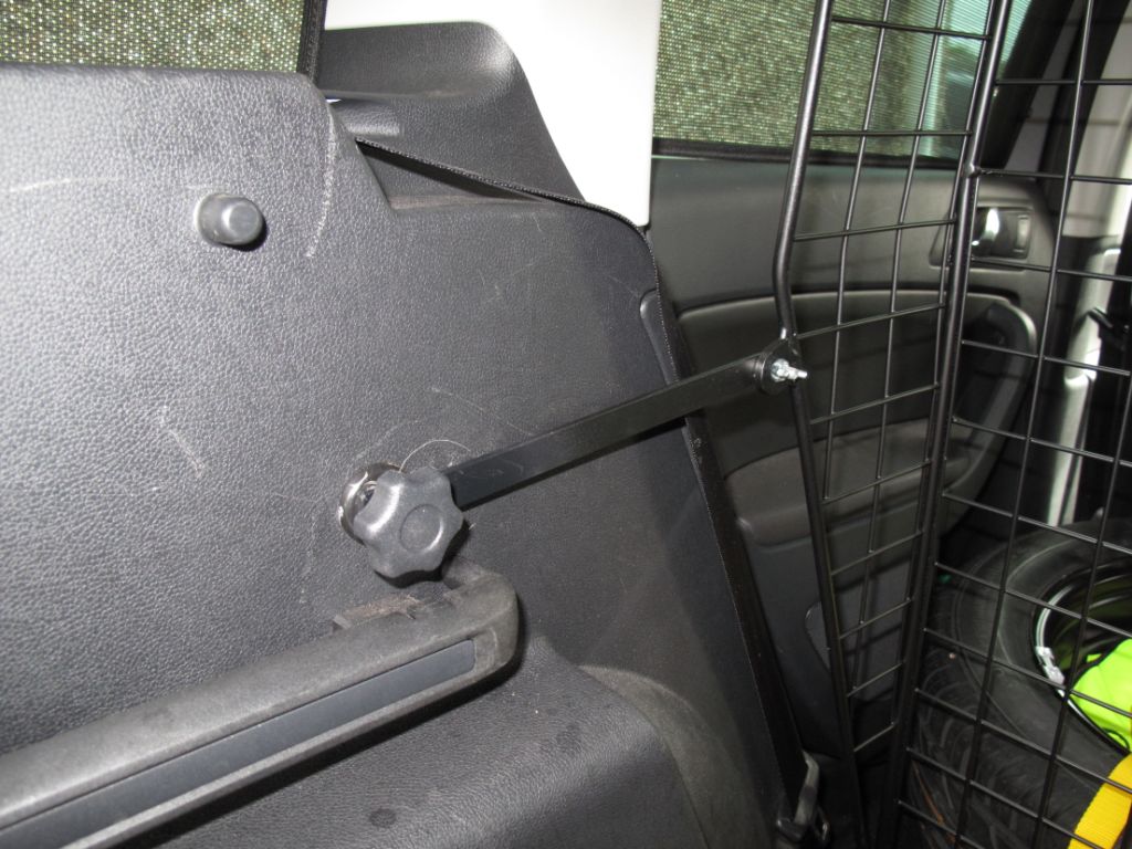

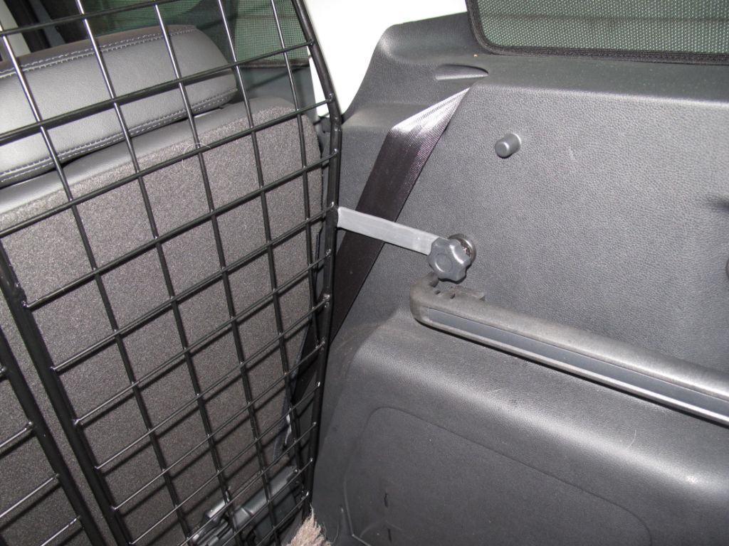

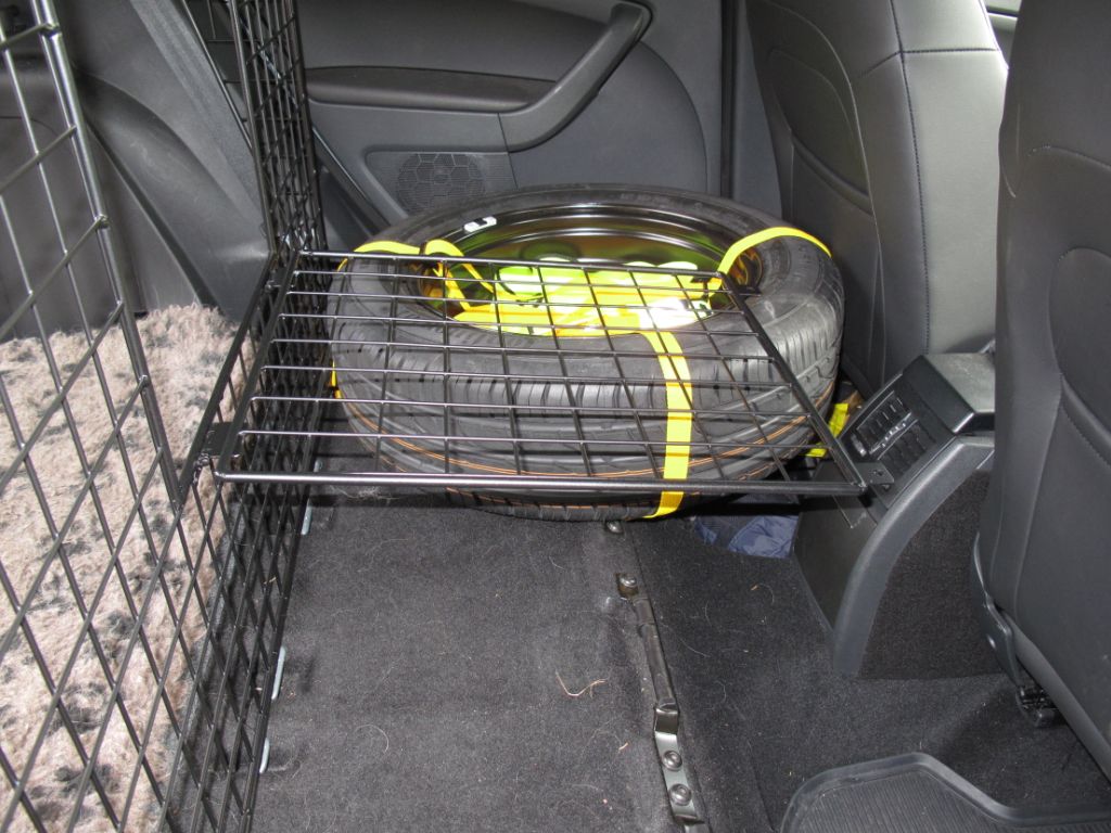

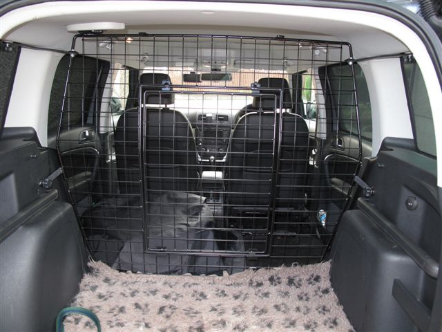

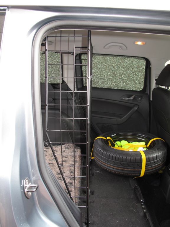

I started off with the spare wheel, raised floor etc and the dealer fitted dog guard/luggage restraint. I have two golden retrievers which we take to dog shows all over the country. Personally I think there is plenty of room for two large dogs to travel in comfort in the existing floor space in the back of the car, without a cage, but as my older dog travels everywhere sitting up I found his head and upper body a bit obtrusive when under way, and also he looked slightly vulnerable sitting high. The factory dog guard as fitted curves into existing “head space” and restricts it quite markedly with the high floor, so I bought the parts to lower the floor (about £70 from memory, different floor cover and foam insert) This lost me the facility to keep the spare in the boot, but as there are only the two of us now I was happy to take out the middle and left seat and keep them out. This allows me to have the spare on the floor (secured with tie-downs) and you can keep the jack etc within the wheel. We still have plenty of room to carry all the show paraphernalia, a mobile cage and overnight kit etc.
I threw away the guard and went to a small company in Fife and had a custom full length guard fitted with an escape door in the middle.
This I leave in place all the time, and it’s rigid, mainly because I was able to have the dealer fitted (dog guard) fixing points used to secure it all in place, without them the fitter will have more trouble getting secure fixing points, but it could be overcome, eg use the fixing points for the horizontal bars half way up the boot walls. (I had a second guard made  which extends forward into the back seat space to give the dogs more room, but unless you have a LARGE breed, or >3 dogs, I don’t think it’s necessary).

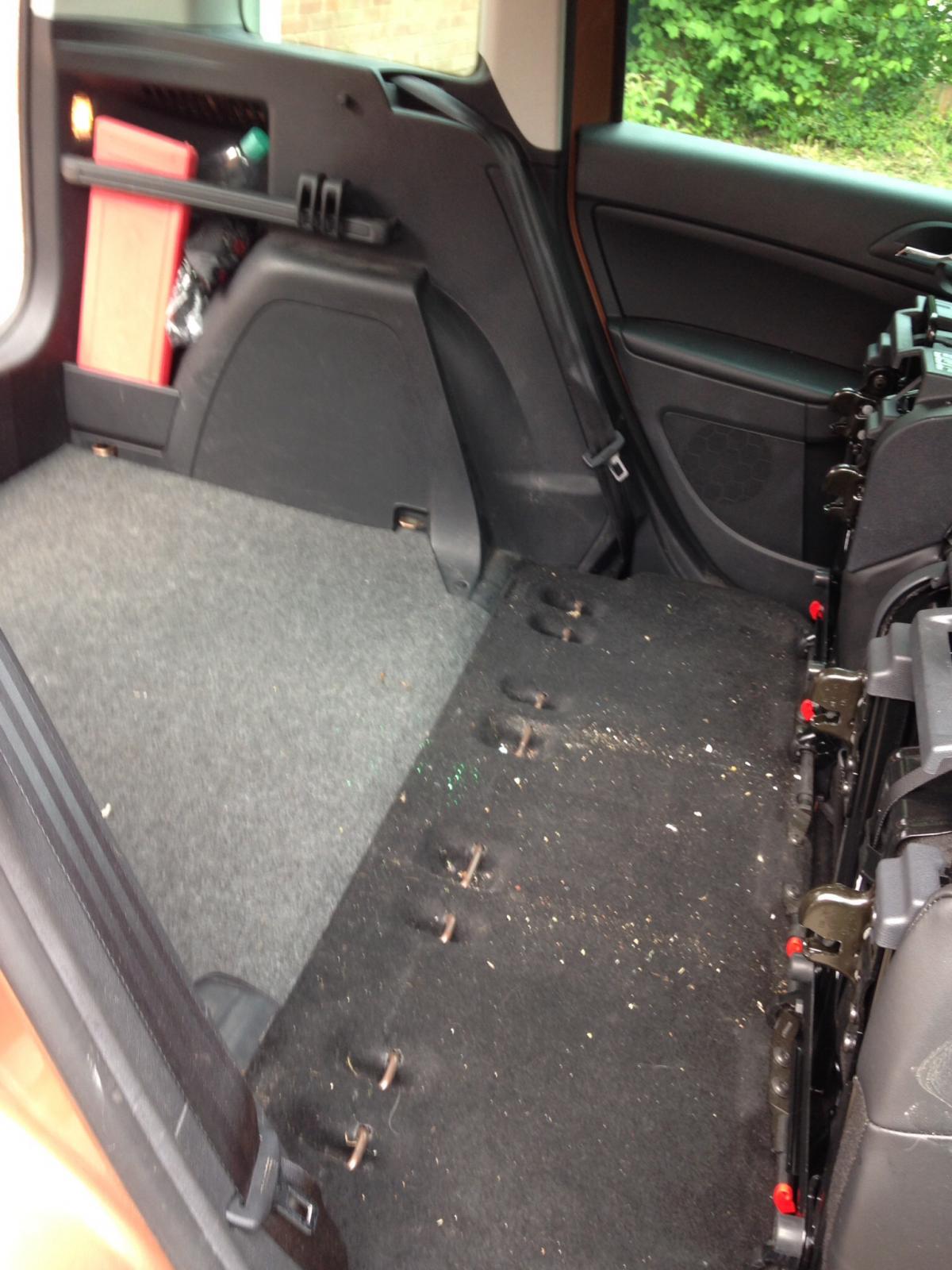

Since I had some seats out/stowed today for some junk moving, I took a couple of pictures. The centre seat has been removed (it is a bit of a faff to roll forward and easy to remove, so I did). Both outer seats are rolled forward and held upright by the built-in bungee hooks, that attached to the front seat headrest posts. As you can see, the floor is pretty flat (excuse the kid-induced mess).

Thank you Weasley, the images are very helpful.
I didn't get a chance to go to the dealers the other day but am now satisfied that there is enough flexibility in the seating to suit my needs.
