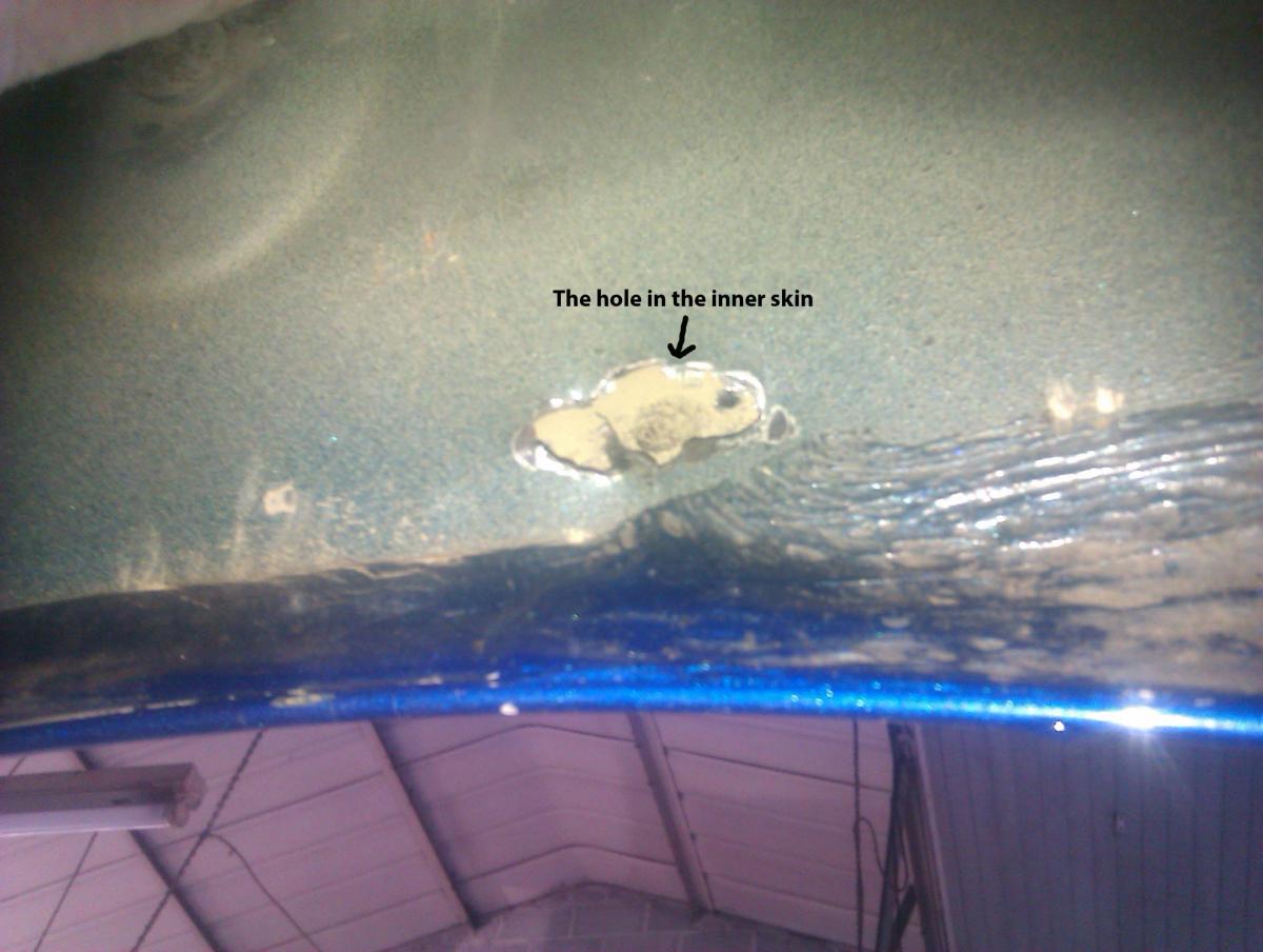

A few weeks ago I had a 'reputable' PDR company out to look at a small dent on my rear wheel arch, (2010 Octavia VRS). The guy reckoned he could do the work and I left him to it. After about 10 mins he knocked on the door and said he couldn't do the repair, there would be no charge and off he shot.
Investigation of his attempted repair showed that the slight smooth dent now also had pointed raised metal, the wheel arch liner had a hole cut in it, and above that hole had been chiseled a jagged hole through the metal inner skin. He had made this to access the dent in the outer skin. This has left the wheel arch double skin open to water ingress. I have had a temporary repair carried out to plug the hole for the short term but I need a permanent fix.

You as a priority need to get that into a decent bodyshop then take action against the company that left you with this mess....at least get them to cough up for putting it right.
By the way I would suggest any paint/bodywork repairs not carried out by an insurance (or better still skoda) approved repairer will invalidate your corrosion warranty.

My own garage (very good independent), do not carry out body repairs but have many years experience and are obviously aware of repair techniques. They told me that the amount of work needed to repair the dent, - (filler), and the paint work - full rear quarter respray and blend in to rear bumper and o/s rear door was probably overkill and that they wouldn't have it done if they owned the car. All they would do would be to silicon the hole and replace the liner.

As a PDR expert he should have done a Glue Pull on the small dent as rear access was not really obtainable. This would have given a satisfactory repair as long as the dent didn't have any creases in. I would say he wasn't an expert.

Just a quick update. Visited the local Skoda dealer and had a chat with someone from the bodyshop. Was given a quote of £550 to do the full work, which is a lot for a small dent and a wheelarch liner, but was about what I expected.
I've been reasonable with the PDR guy and told him I would split the repair 50/50, seeing as I did have a dent before he started!
Quite surprisingly he has agreed to this and says he will send a cheque once the repair is complete.
Doing it this way, I get a warranty on the repair and keep my anti-corrosion warranty. If he keeps to his word then I will be happy, and it saves all the hassle of trading standards and small claims.
