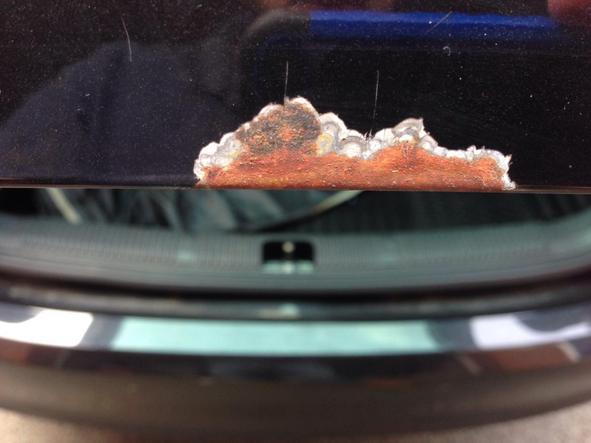

Sorry it's taken a while to upload the pics. I took your advise and bought some Kurust. It seems to have helped. The first pic shows the rust before. I scrubbed it down and had to scrape some more paint off as it was bubbling underneath. I put about 3 coats of Kurust on and have put some black nail varnish on to try and hide it until I can get it sorted. Looks pretty good IMO.

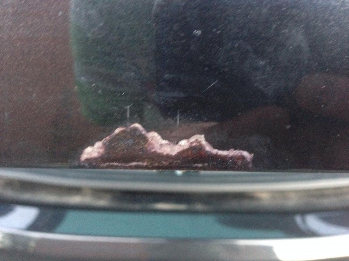

This was after I had put on the kurust. I've not got a pic with the varnish on yet.
You really need that properly repaired now.
Or it will prove costly.
It does look like it was accidental damage to the paint work originally.    Please get the Rust Removed, & the metal sealed.
As above looks like the paint got scratched allowing water in and rust to form under the paint, before it flaked off in one large patch looking at the edge around the rust.
Needs a professional repair before it becomes a new door.
