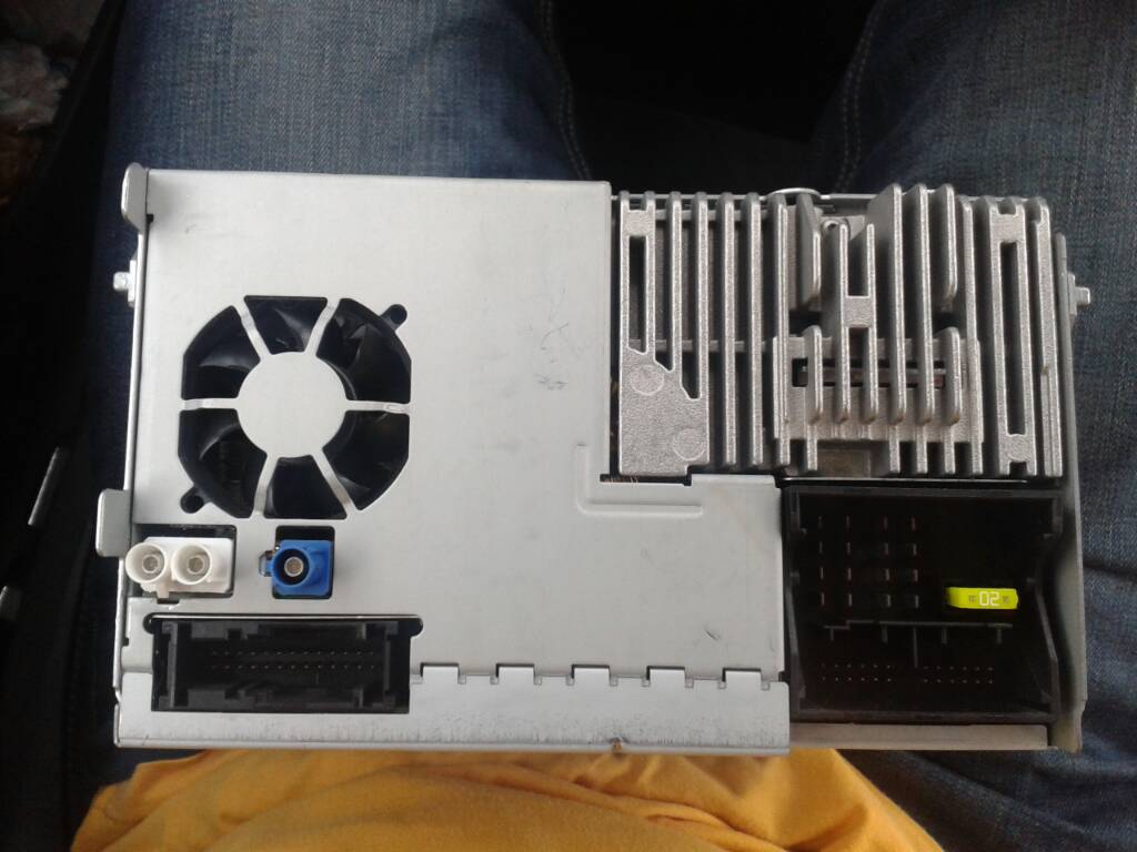

Does anyone have the info on coding a columbus to a maxidot unit, I have some1 with vag com that will help me but dosnt no how to code to maxidot? Any help guys????
Also I have it all plugged in and just woundered what is the plug used under where the aeriel is? Cause I have nothing that plugs into it? Any info thanxs chaps
You think on 26-pin black socket? This is for AV signal, .etc Rear View Camera
And when you change coding of the Columbus, so that menu for Audio and Navigation would pop up/show in Maxidot, after coding is accepted you need to restart your Columbus by presing buttons < + > + VociceDial (button next to the Eject of CD/DVD) in same time.

Thanxs for the help guys, culd u talk thru it step buy step as if u was doing it as total noob at this lol.
Also will this give me bck mfd, audio
Then nav ?
ow ok cool yh big plug at bottom :)
