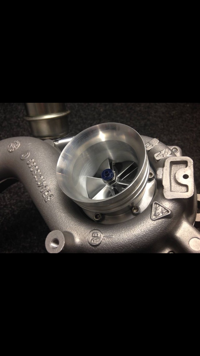

The made my a TIP but don't know if it will accept a 3" MAF??
Wow that turbo intake looks big! Nice :)

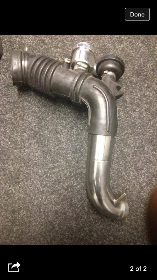

That's not going to fit a 3" MAF. You could use a reducer if you have space. Won't fit if you're using standard airbox though.
Or get hold of a TT 3" TIP and mate it to the metal pipe like they have.
Or forget the 3" MAF :)
Once you start doing this sort of thing you end up having to get creative :D

The question is, is it really worth the hassle? The MAF itself is identical, just the housing is different. And the air is going to get forced down through that 2" (ish) intake anyway.

I'm not 100% sure why they have trumpeted it as that's not the bit that is restrictive so will see how that works
Speak to sfs and give them outer diameter of the turbo and tell them you want a supersize tip 3inch maf end
thing is with doing that to the turbo your making it hard to fit a tip on it as there isnht much room there for a tip that's that big if that makes sence?
my Neuspeed type TIP on mine rubbed slightly on something when it was on mine.
