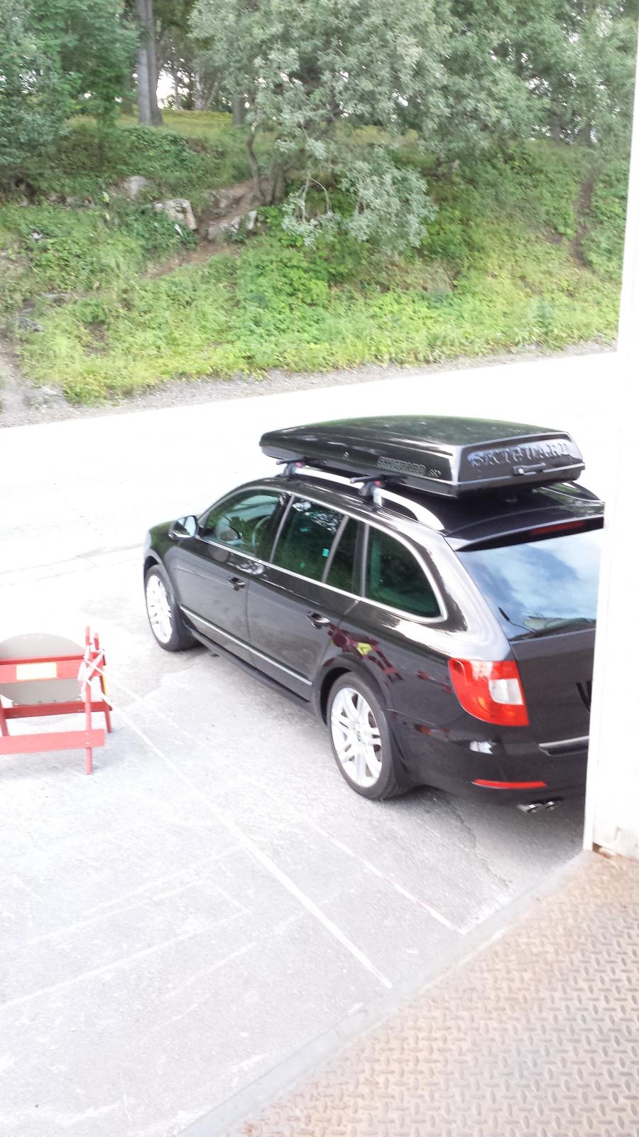

Hello guys!
We do have a Skoda superb R4 170hp 4x4 and is very satisfied with it. It has 51K miles on the odometer.
