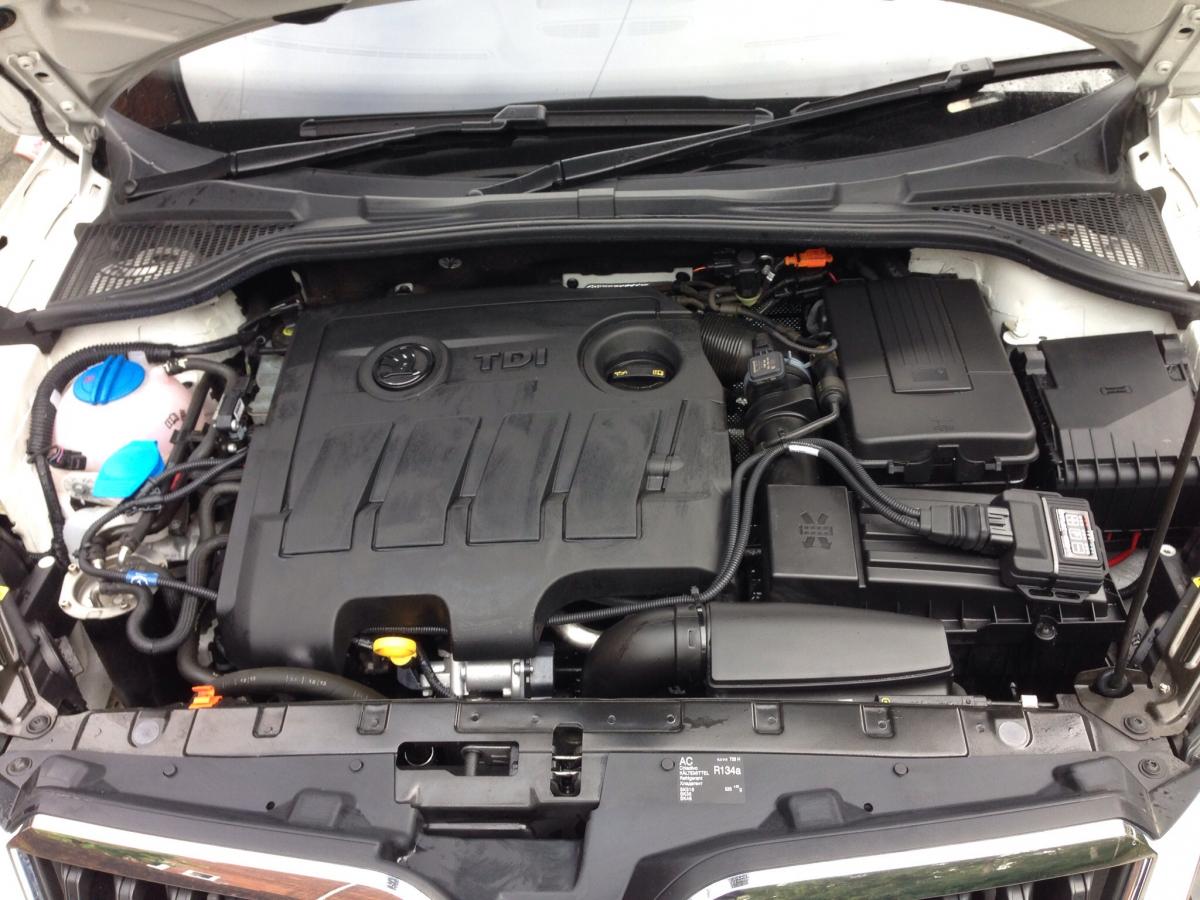

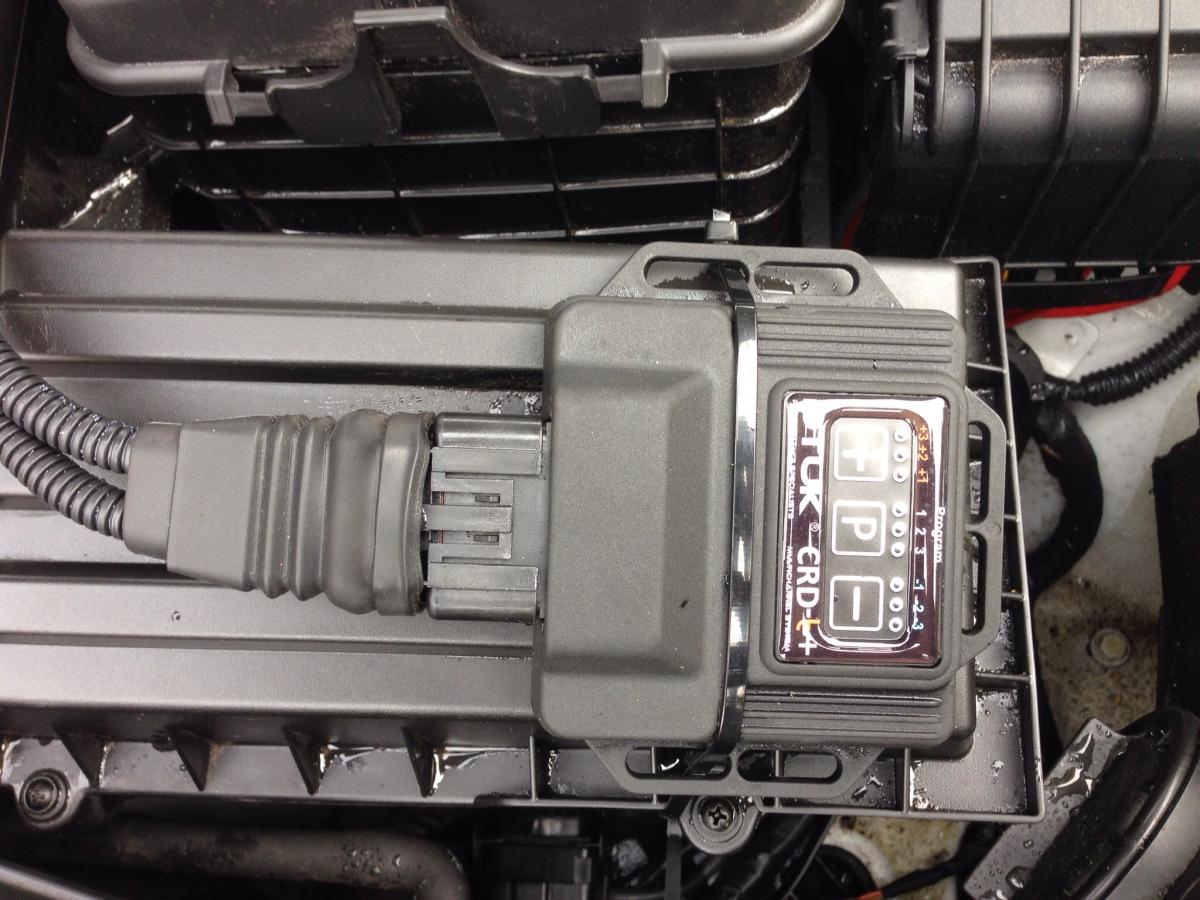

I've just fitted the new CRDt+ plus from DTUK, it connects to the fuel and boost sensors and I'm over the moon with it, good as any remap I've ever had.

If you buy a £20 magic chip from ebay guaranteeing 50% increase! I had a little help fitting my CRDt+ from a friend who has run his own successful garage for 30 years and drives expensive AMG mercs.
After fitting and a fiddle he was really impressed on the gains my DTUK box gave and as it connects to the boost and fuel pressure sensors he confirmed that it's a "quality piece of kit" and "as good as any remap" he's seen.
Is yours the CR140 or CR170? Did you have to remove the undertray to connect to the boost sensor or did you manage it from above? Will be going with a CRDt+ box next year now i think as the funds i had put to one side a couple of months ago were used when the mrs' vRS needed some repair work doing.

It's the Greenline but with the box I recon almost a CR140, rolling road next week will give the exact figure :)
I took it around my mates garage to use the ramp so I could go from underneath, I could just about reach with from the top but the tray drops of in 10mins. The controls on the CRDt+ make it so easy to fine tune, pull over, leave engine running, adjust settings and off you go.
