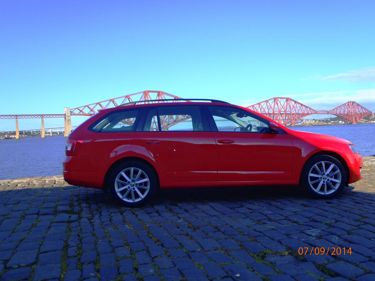

No action shots, but here she is in her unwashed state yesterday. Gives you the general gist of how it all looks (better than 16s IMHO).
