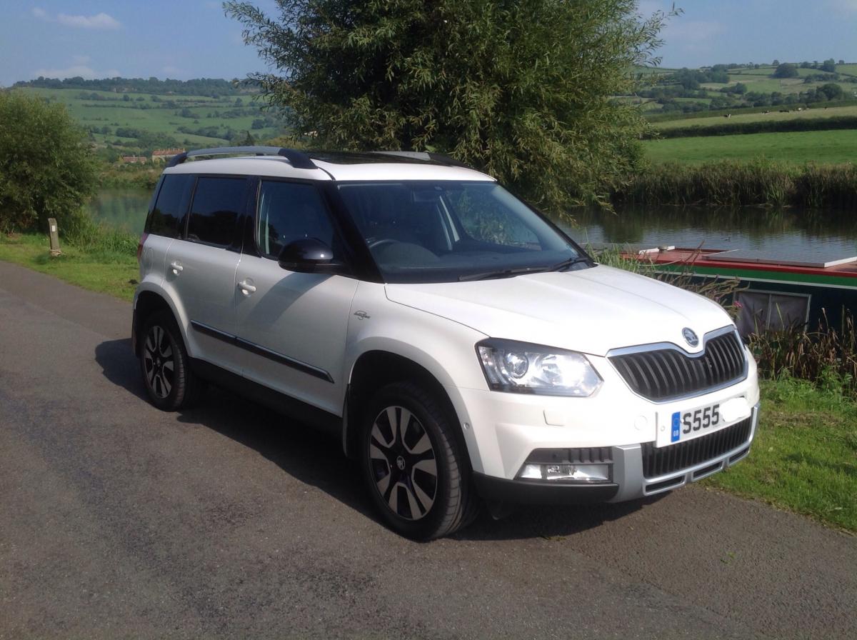

Mine is done now too.  I did it 20 minutes before driving to near Toulouse in France on the 5th. These black beauties now have 1,808 miles of French bugs splattered over them!

I love how the mirror is now nearly an identical match to the A-pillar.
