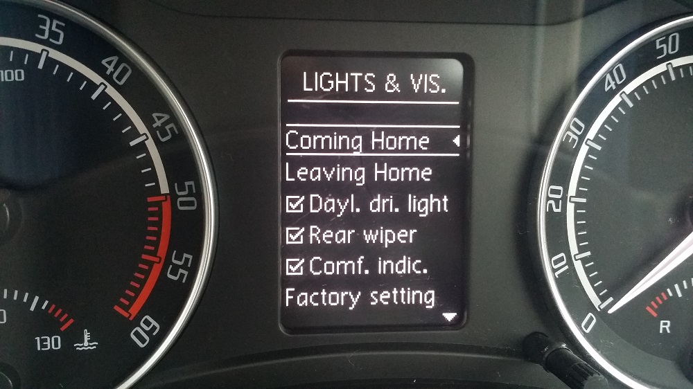

I have activated CH and LH lights, it shows up in maxidot menu. I can set the time on, but it is not working when I lock or unlock the car, open the door. What Iam doing wrong?

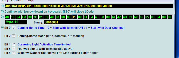

I dont have auto lights. I think for autolights you have to tick bit 2 in byte 12. So it will not work without light sensors?
Does it work using your headlights if you untick bit3 on the second picture?

Also try ticking bit 2 on byte 12.  Is there another bit that relates to "personalisation"?
Ok, its a FL model :)  I have tried to tick bit 2 on byte 12 but the same.

Control Module  > [09] Central elec / Coding / Long coding helper / byte 17/ bit 3, tick the box.

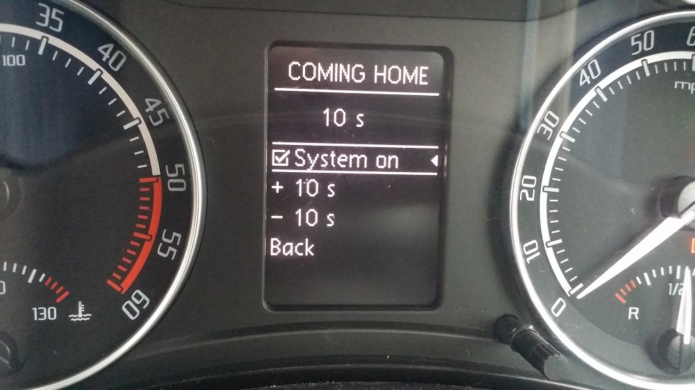

what is also interesting is looking at your maxidot image zoli888777, yours says "system on", whereas mine says "switched on".  This is mine.....
