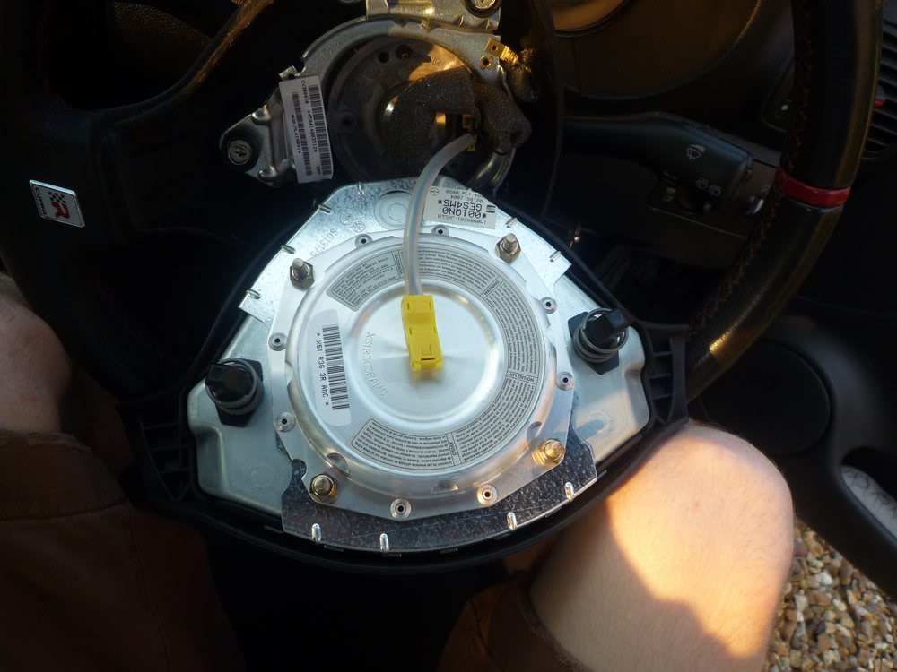

Watch some videos on youtube.  I struggled to remove mine until I watched a video to work out which way I needed to flick the retaining spring clips
Unplug battery for 30 mins first ideally - get rid of any residual current. You can do this without disconnecting the battery if you're careful but it's a freaking airbag and i'd always err on the side of caution :)
Once you have the wheel in the right position use your tool (I went with an old drill bit) and by feel you should be able to get at the clip. You want to insert it so that the end that sticks out of the hole is pointing slightly downwards towards the floor of the car. Tug the tool ( :D) upwards and it'll unclip.
Pic shows the airbag removed, you can see the little sprung clips that need to be unclipped if that helps visualise it.
