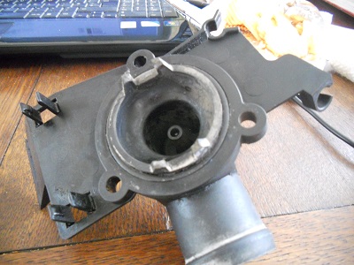

Hello, recently replaced the radiator on a family members felicia and now the plastic tabs holding the thermostat in place have decided to break too wich seems to of resulted in coolant spraying out around the temp sensor, just after filling with new coolant . . . It seems the plastic bits have gone down the engine, is there a chance these will do damage?
After some reading i have a few questions, first is i read cheap ebay ones arn't always great so any suggestion of where to get one would be great? I'm only really looking for the empty casing if possible. Found this on eurocarparts http://www.eurocarparts.com/ecp/c/Skoda_Felicia_1.3_1997/p/car-parts/car-cooling-parts-and-car-heating/cooling/thermostat-housings-gasket/?200440221&1&8fa7ec7aacea37678acd3aa3a2a92618f50a20ba&000575 but the pictures entirely different so not sure if it's a generic picture or not.

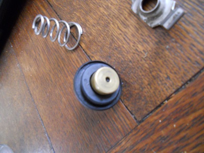

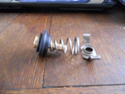

I think i have all the parts of the thermostat in the picture below?
In the haynes the picture looks like the thermostat has a pin looking thing coming out of it, just wondered if the hole in the end is meant to have anything poking out?
you don't want foreign objects in your cooling system for two reasons:
- they can choke the flow of coolant -> overheating, no heat from heater, etc
- they can get stuck in thermostat or pump blades -> bad day
there are bits missing, see photos.
