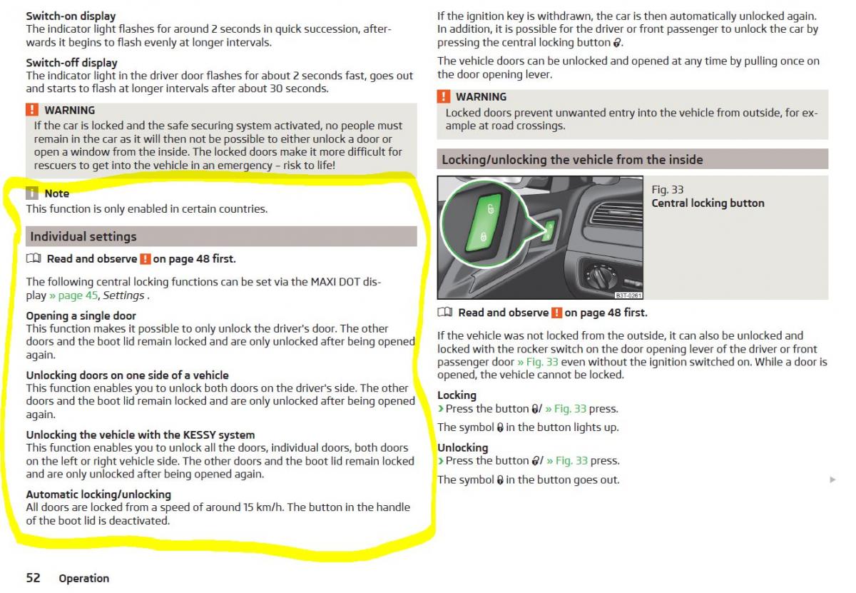

Long shot, but your central locking is nothing to do with this is it, maybe not,
