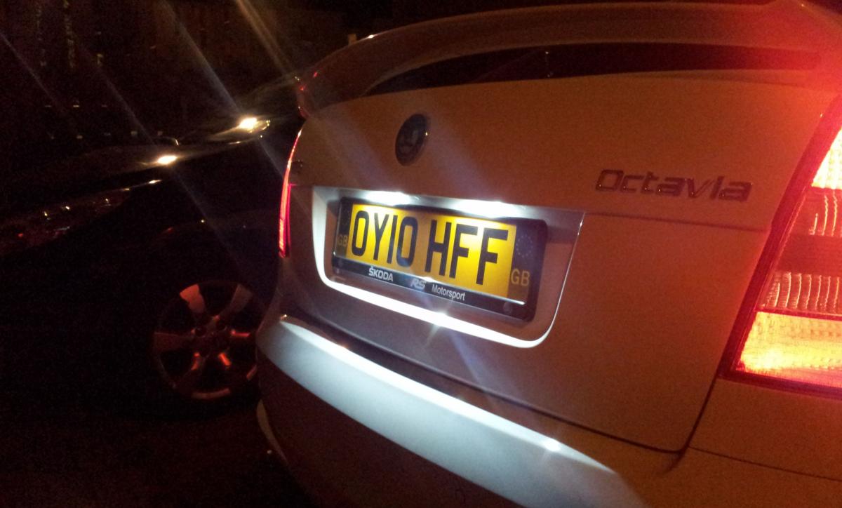

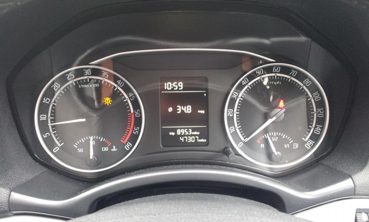

does anybody know how to remove this light error from my dashboard? Or which LED bulbs should I buy to avoid this issue?

Re-code for LED number plate bulbs on VCDS
