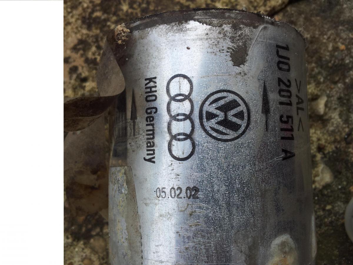

I did my fuel filter today finally and to my surprise it was the original one from 2002!! needless to say the petrol coming out was black! so worth checking yours if you haven't already.
How long have you had the car?
When i had my mk1 octavia vrs i replaced the fuel filter & to my surprise it was the original,my car had 120k on the clock & was 6 years old when i serviced it & it had a full skoda dealer history. I recently replaced my filter on my mk2 vrs @ 55k & 6 years old & the fuel that came out of that was a rusty brown in colour as well.
I've had the car about 15 months, I dunno why I never checked it when I first got it really! car has done 130k as well.

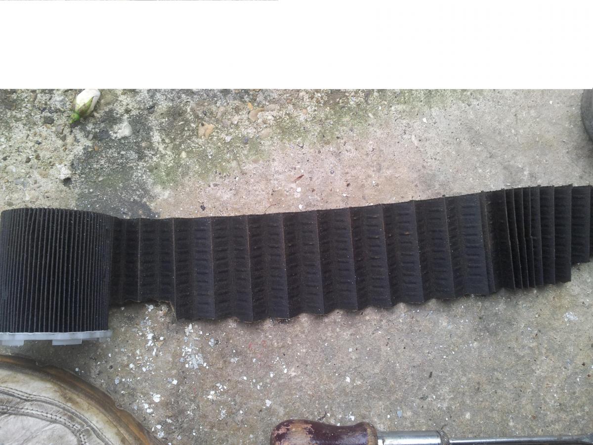

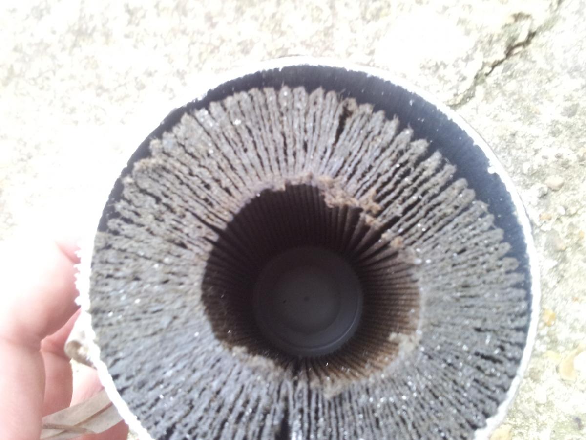

Should cut it open and see what its like inside :)

Clips come off easy with my fuel clip tool ;), yeah I will get the hacksaw on it soon.

Here's the pics of the insides!
