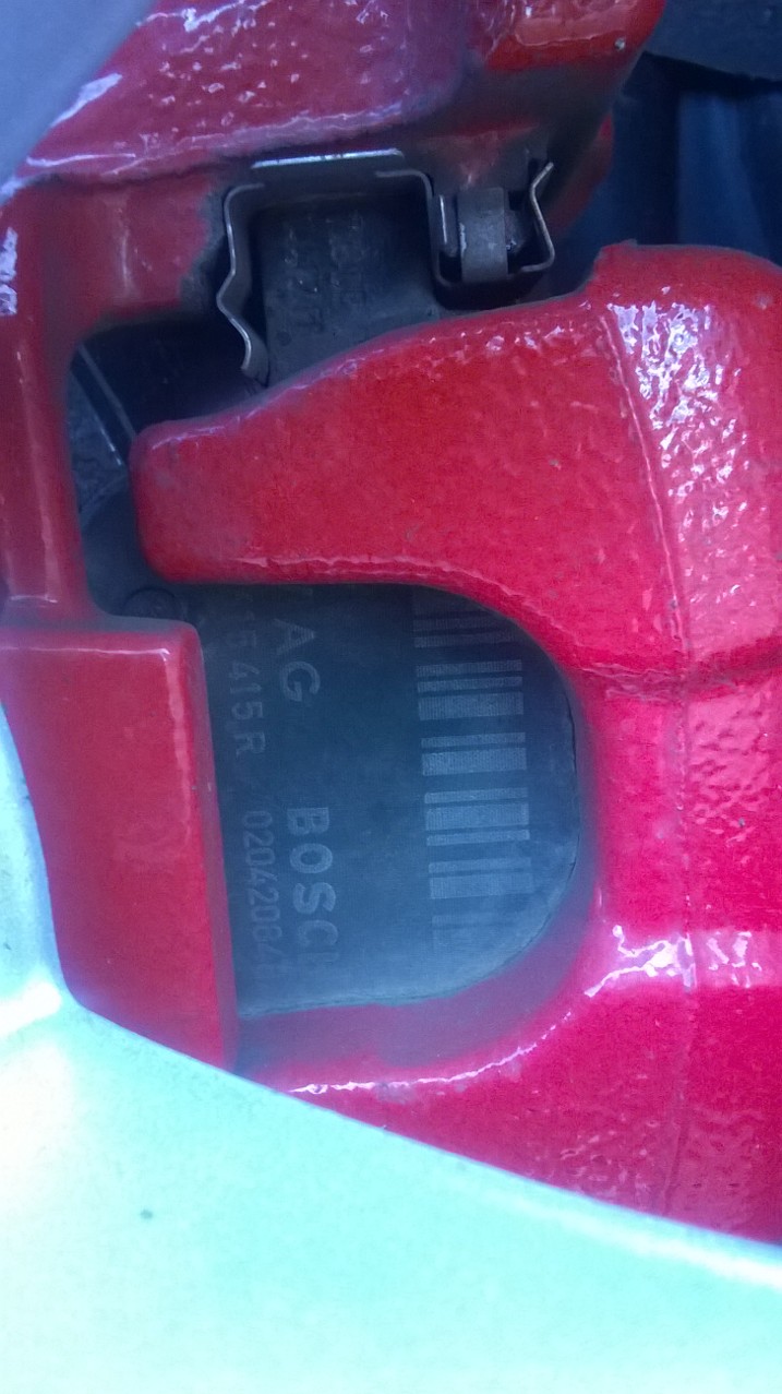

Can somebody please tell me the replacement parts for these discs and pads? I googled bosch 020420848 but it pretty much came up with sweet fa  :S
Have a look on the sticker in your boot ( it will have a number like 1pr or 1zf / 1zm, this will tell you what size brakes you have). On my VRS which is a CR TDI I had the 282mm rear discs. I am pretty sure your are the same.

Looks like I've got 1KT which might be some cheapo pads at £21.54 - just need to suss out the discs now...
Edit: yeah it looks like 282mm discs
