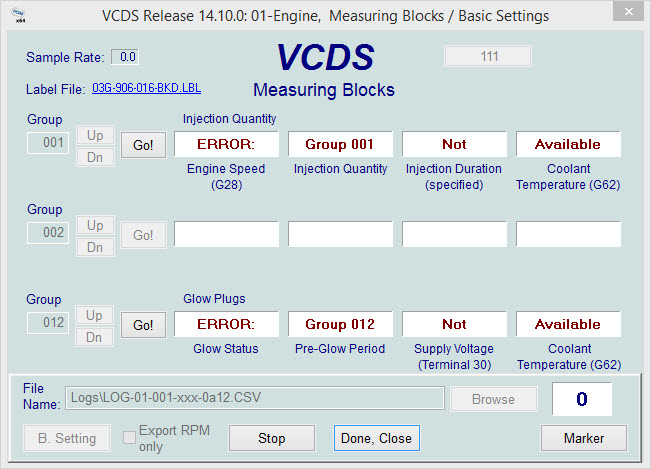

VCDS
I tried logging some data but as soon as the issue occurs, VCDS logging stops and reports errors on the log screen for each measurement (Attached)
