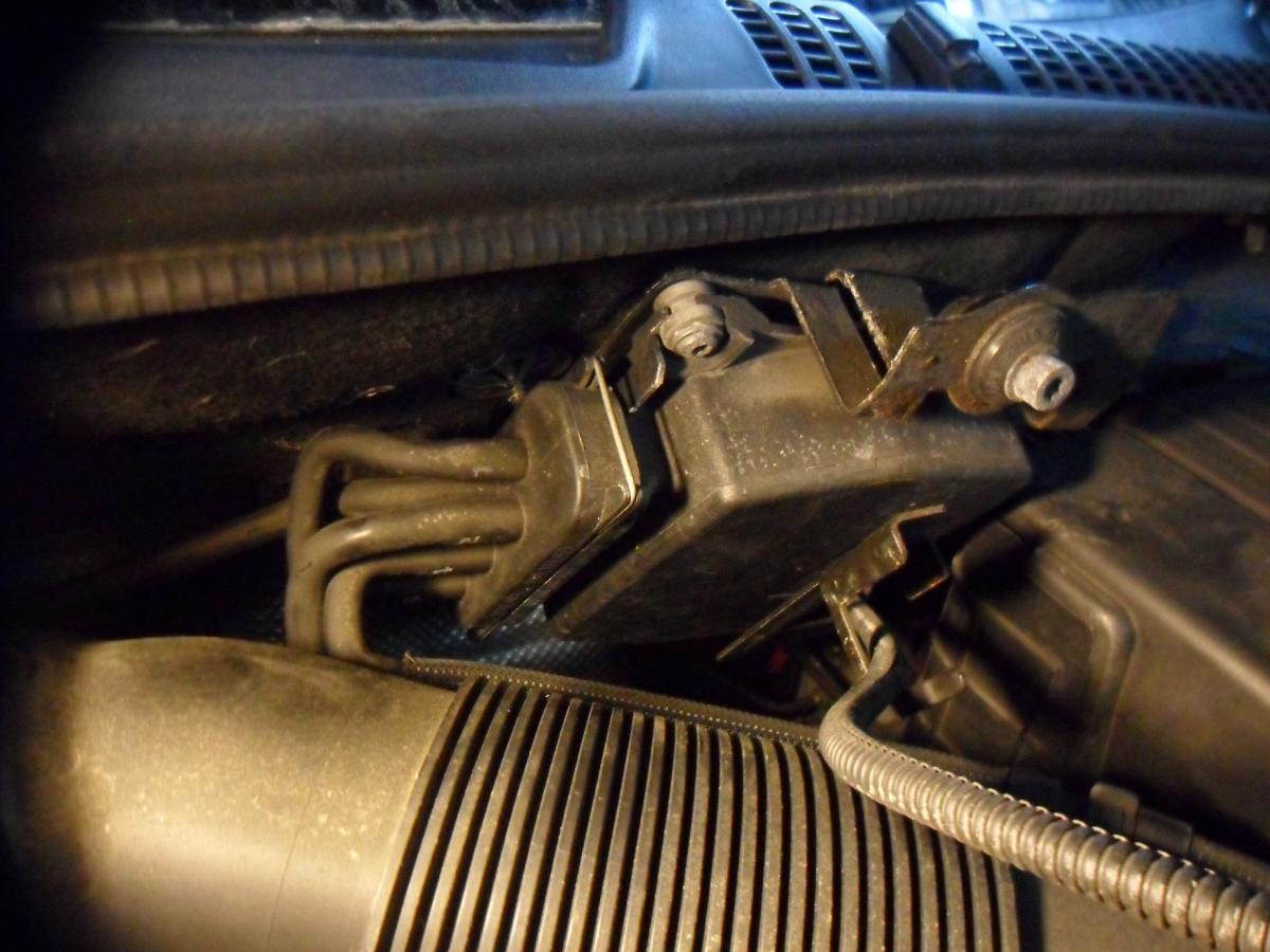

Just took a picture of the noisy culprit under the bonnet and it seems to fit your description.
Yes, that's the one.

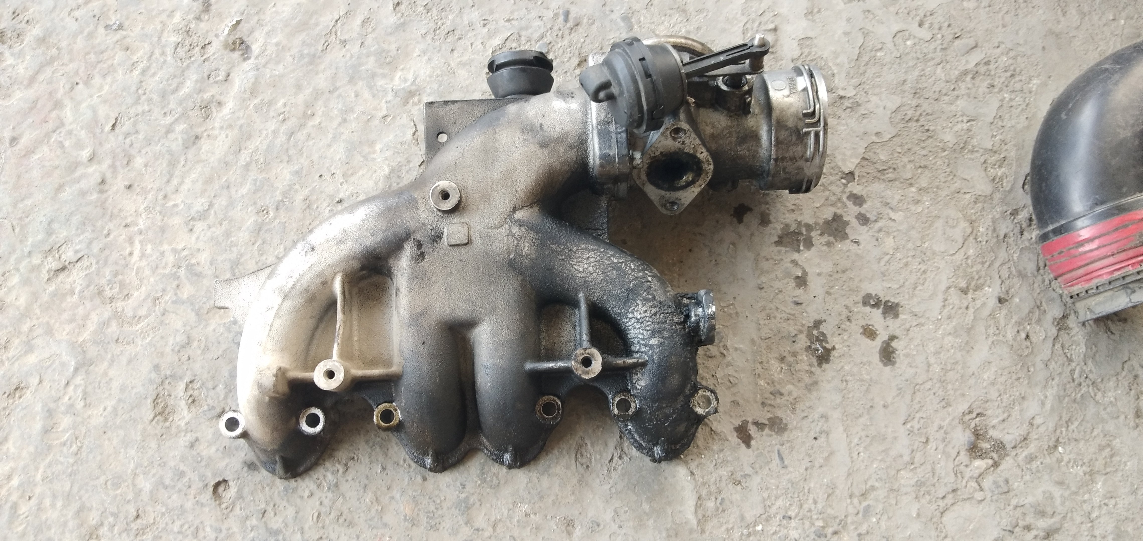

Hey nick! Buddy i just got cleaned my skoda laura egr valve cleaned after dismantling.. But no issue with pickup only creating a vaccum leaking sound when i deaccelerate it from arnd 2500rpm.Intake hose also getting puffy on accelerating high
Please suggest

Hey!
I hardly visit this forum now as I sold my Octavia in 2014, but I got an email saying someone had quoted my post.
Your problem sounds odd, particularly the intake hose getting puffy on acceleration. I wonder if you have a partially blocked intercooler? Or Perhaps the anti shudder flap is sticking partly closed?
