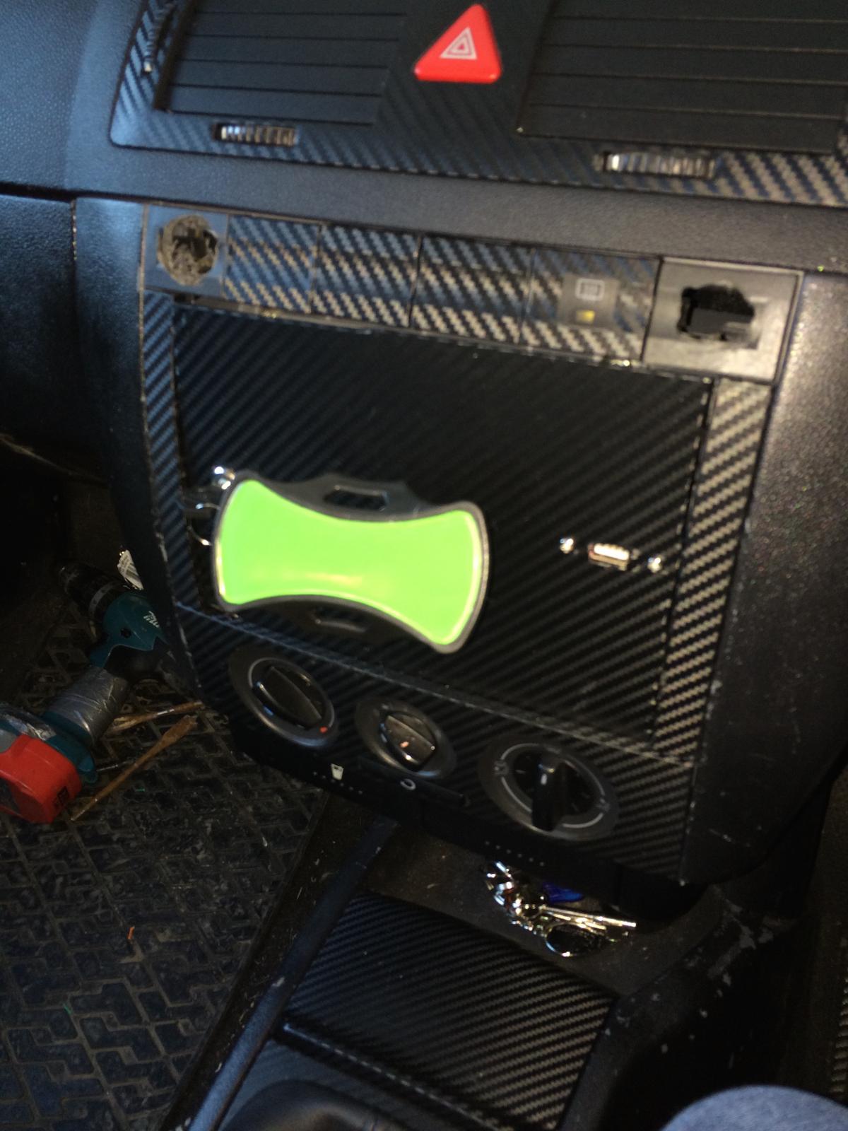

to do this we will create and in dash USB that we can mount in the existing hole of the radio
now we how our power source and AUX cable sorted, we now need to cover up our work and cover up the hole in the dash not forgetting to feed the cables we fitter to the cover, you can use whatever material you need for the cover, i used plastic and covered it in carbon wrap and used plastic dowels for the strengthener
you will also need to add your iPad holder/bracket to your cover so it will need to be strong unless you mount it to the radio surround and build the cover around it.
you can now have your iPad held in securely and connect it up to your car and used as your radio whilst hiding the wires and making it look smart, on the bonus side you can take your iPad out the car when you leave meaning it is not a security risk as it will just be a cover and a bracket, you could take the cover to the next level and have a pop out/removable mount/bracket for the iPad but theres always room for improvement

to finish off the dash mount i made a cover out of plastic and wrapped it in carbon just to make it look good, cut holes in the plastic for the aux, usb and iPad mount and its good to go

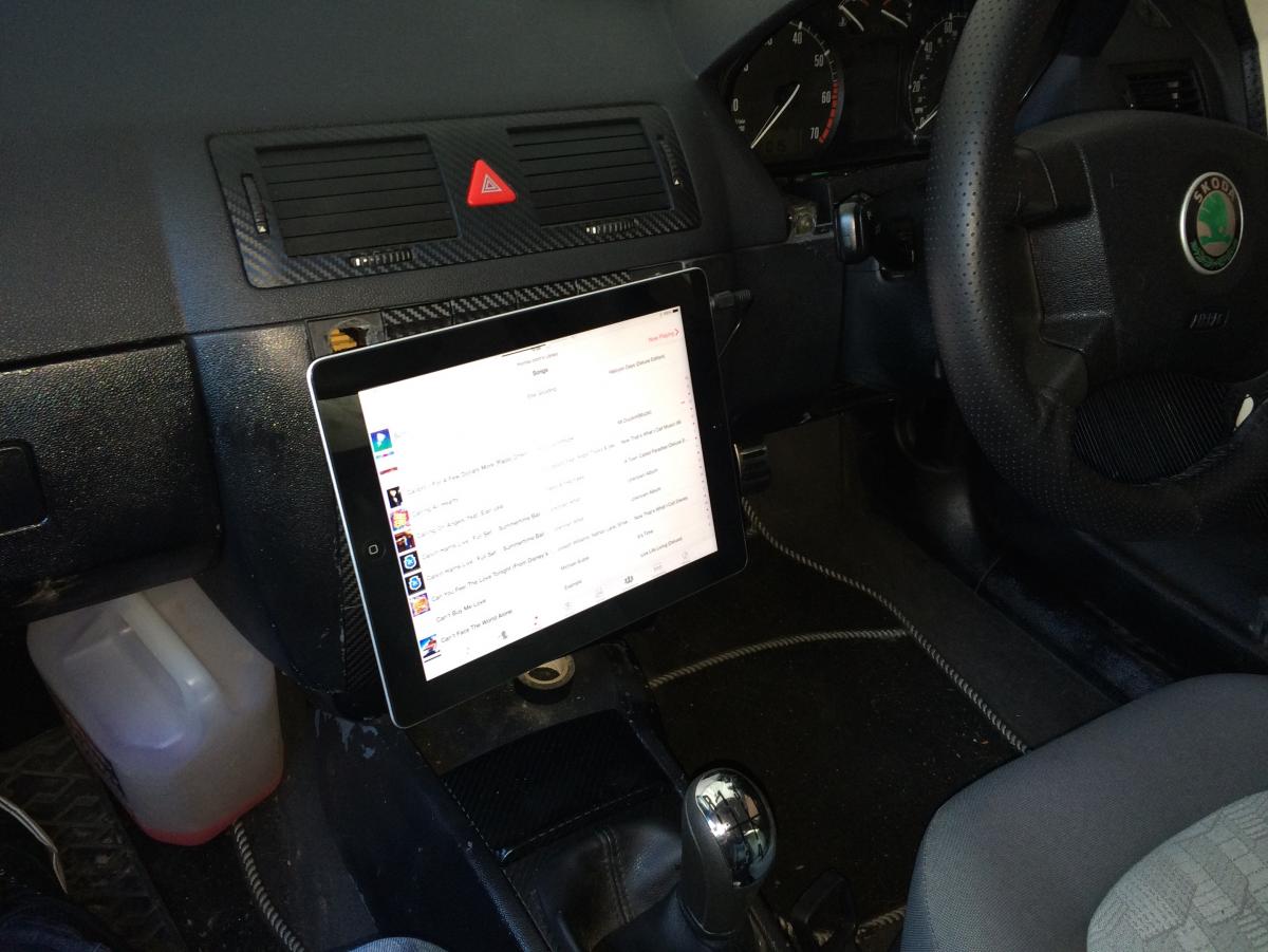

Looks a little bit... Big? :D
yeah the picture was my iPad 4th gen, not my mini haha still works just as good plus the holder will holder anything
1. That's a big no no IMHO ... GPS reception is poor if you install it over there. - possible fix with an external antenna ... but things are getting complicated, right? :)
2. If you don't care about navi and stuff, I think this is a way better option.
Edited by Alexandru
Looks a little bit pikey IMHO
i tether the iPad from my phone, the routes i go are luckily covered by o2 so i very really get limited coverage, i haven't found an issue with it yet
it does i agree but with the part i had and me not willing to for out for a big expensive navi unit i wanted to do something myself, you could say the car has carplay now haha
If you like it mate, that's all that counts. I can see the pros and cons.
Not many double din head units will have the smooth running of an iPad, easy to add new music, use sat nav and radio apps if needed.
As you mentiond Siri should work really well with it so voice activation is a big plus.
I quite like the look of the new pioneer SPH-DA120
