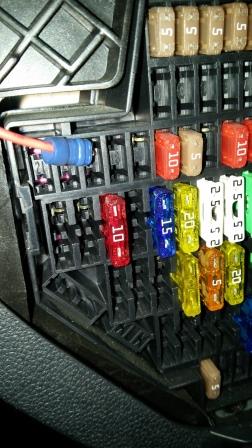

Have just purchased an "add a circuit" dooby off eBay. Seems the most rational way to get my 12V.
OK, so my add-a-circuit fuse piggyback arrived and.... All of the fuses I've tested in the fusebox seem to have permanent 12V.
Is there a fuse that only gets power when the ignition is switched on?

I'm in the same boat. Need an ignition only live from the fuse box but they're live.
Don't want to put a switch in
Can power be taken from the power supply going to the stereo?
Rear heated window is switched live I believe. Check the fuse diagram in pinned section
Tried that, fuse 39, permanent 12V.  :(
this position is switched as it is the one I am using
Rear wiper.
That's what I use. Only comes on with ignition.
D'oh, that's a mini-fuse. Need a different piggyback and fuse for that one. Will give it a go.... Possibly it'll be lower profile too as the current piggyback is definitely touching the fusebox cover.
Rear wiper.
Used this first thing this morning.... Worked a treat :) even better because I don't have a resr wiper :)
I succumbed to the switch option. mainly because I can't be arsed to wait the 2-3 days for another eBay delivery then pull the lower dash off again.
