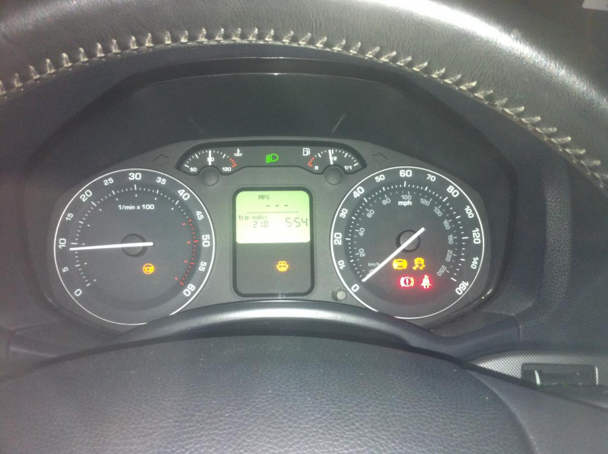

Evening,
So I installed a new battery this morning. Ignition was off. Nothing untoward happened. Drove for about an hour and all was well.
Driving home the dash lit up like a Christmas tree.
Power steering light was yellow.
Abs light was yellow.
Traction control light was yellow.
Handbrake type symbol was flashing red.
I pulled over and as per the hand book checked the brake fluid. No problems there.
Started the car and got the same lights.
Also.
Speedo stopped working
Fuel guage going up and down.
Steering is also heavier.

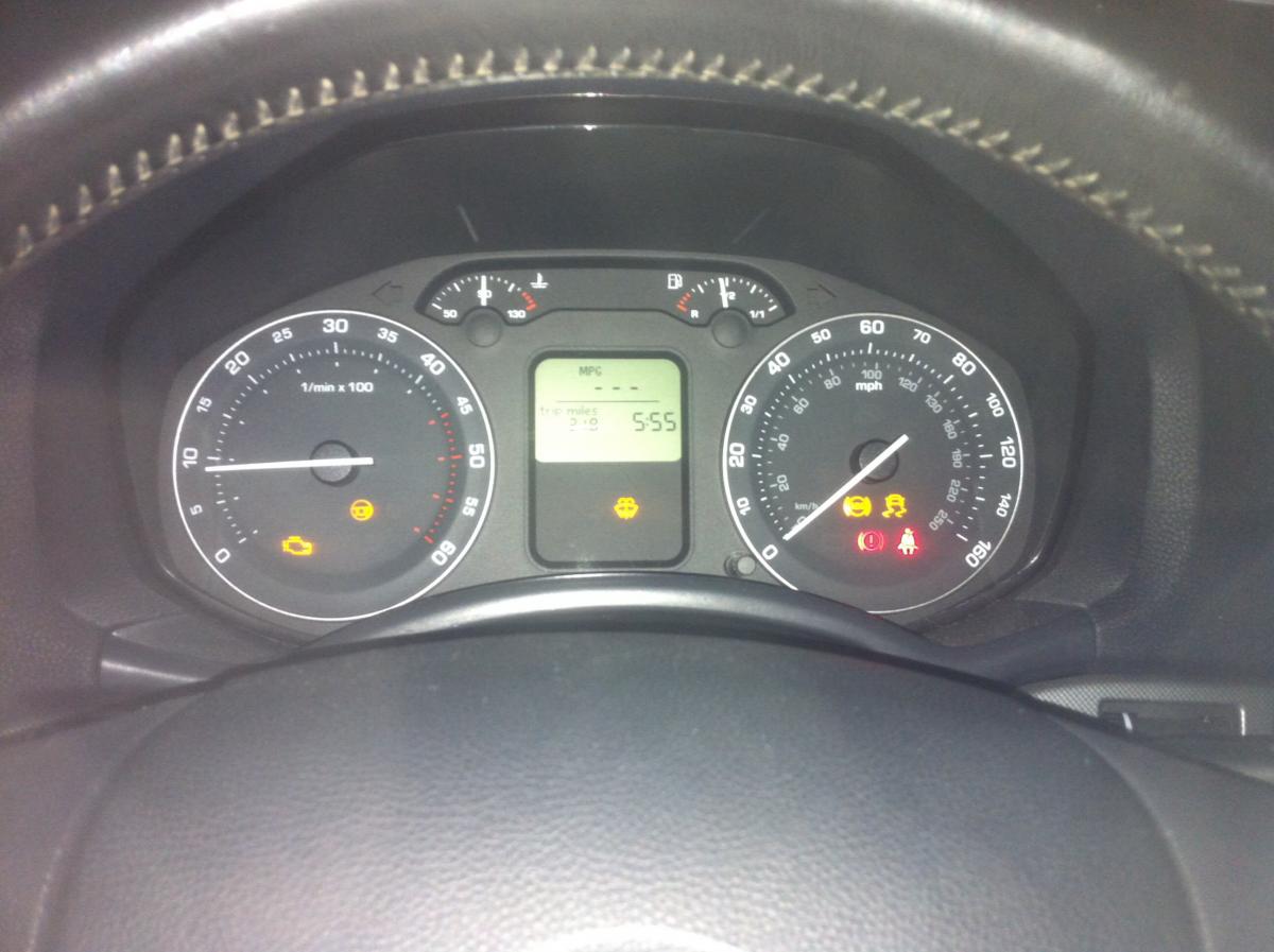

Stopped at home after a couple mins driving. Turn off then on.
EML now on as well.
What the heck is going on? My friend is going to bring his VAG reader and after that I'll take it to a specialist.
In the mean time - anybody got any words of wisdom?!
Thanks
