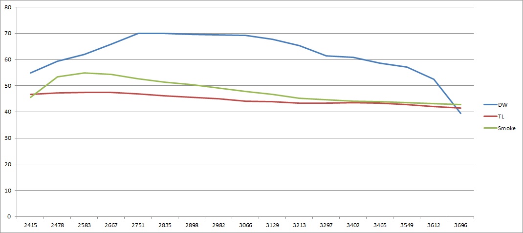

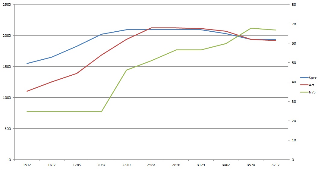

To rule out turbo pressure and fuelling request log the following.
Group 11. This will show actually pressure compared to requested.
Group 8. This shows the fuelling request from the accelerator, torque limiter and smoke map.

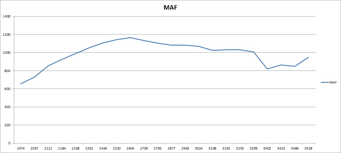

Group 3. MAF sensor reading.
Log all 3 separately (so 3 logs). Using 3rd gear from 1500rpm to 4-4500rpm.
You can email me the logs (pm me for address) and I'll post the results in graphs.

Group 03 - Airflow through the MAF sensor. This is fine.
Group 08 - Fuelling request is fine. Smoke MAP isn't being limited due to airflow through MAF or boost. Cant remember is the 1.4 is MAF based of MAP based.
Group 11 - Boost is looking fine

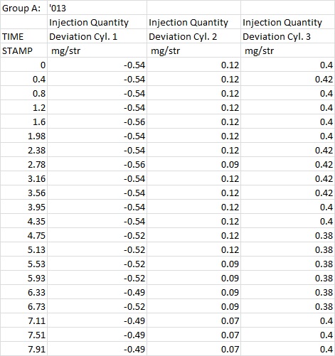

Group 13 - Injector idle is looking fine.
