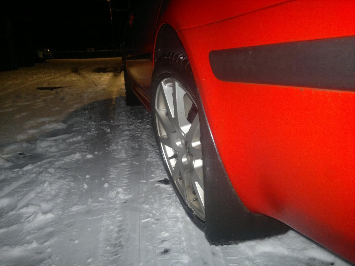

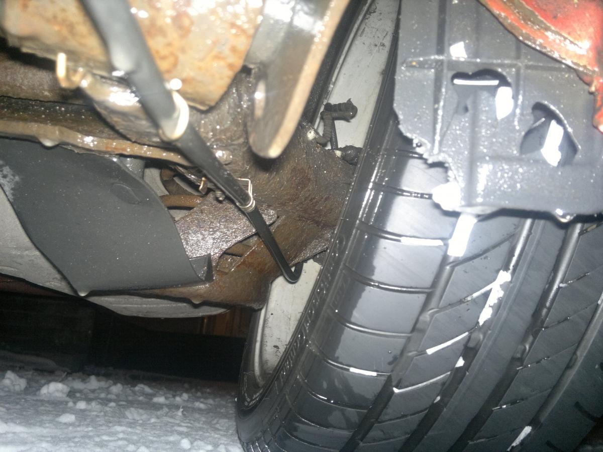

i was round the corner from my houce wen the back end steped out on a corner at 15-20mph, i tryed to catch it but couldnt, i hit the curb with a bang and now my back wheel is bent inward at the bottom, hopeing it will be the stub acsale thats bent but think it might b the beam, does any one no how to chang a beam, and how ti tell if its bent? Getting bussy with it tomorow wen the sun's out..

Oh dear, your rim looks mashed too
Beam is fooked
I have a new one at my unit for £75 of you want ready to go with polybushes new clips and new brake lines

Hopefully stub for your sake
its not good like, think it is the beam, wont beable to swap the beam out by monday, does it need to b a vrs beam or can i fit any mk1 octavia one?

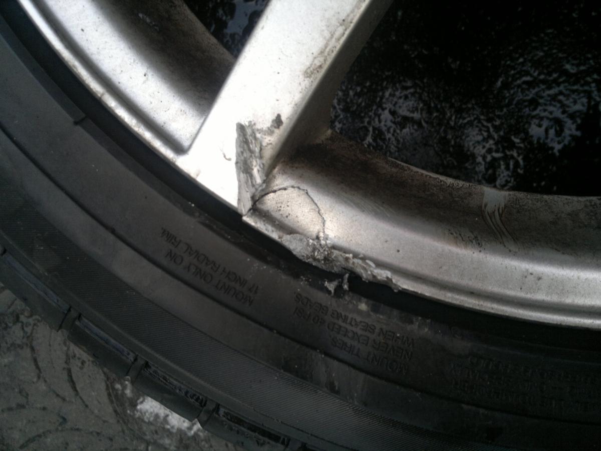

it is curbed prity bad like, fot a spair thankfully...

if i replace the beam does it have to b a vrs beam or can i fit any octavia beam tdi etc?

Elegance tdi is the same :)
got busy today and it turns out my beam is bent to hell n back,
managed to get a vrs beam with all the brakes still on it for£70, picking it up tomorow, wat a misson!!!

I would chuck that rim!!

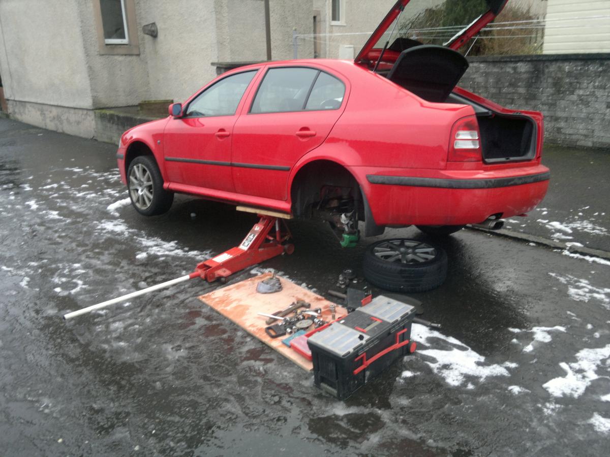

Thats a horrible job to do at the side of the road in this weather !!

you had bearings on the new beam?Nice job in these conditions....I don't even bother to check the oil on this weather.
Hope the weather holds for you, you doing it in the street?.

sadly its is a road side fix, my garage is full of the little girls summer toys, thanks for the kind words hopefully thay will help from freezing to death lol
