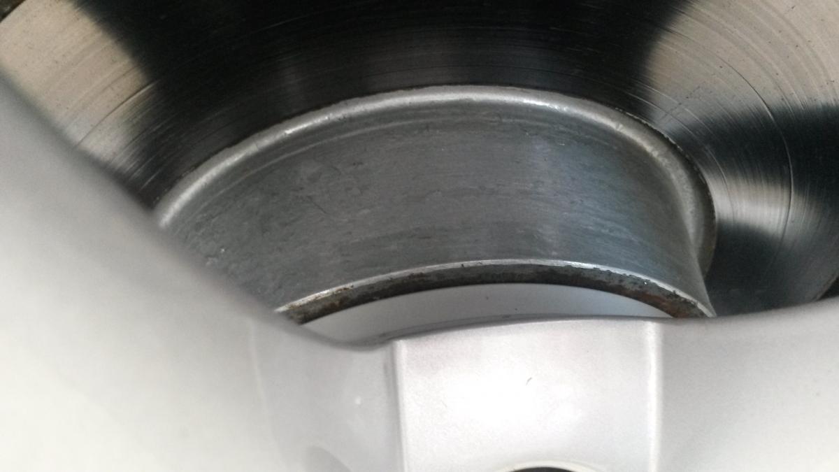

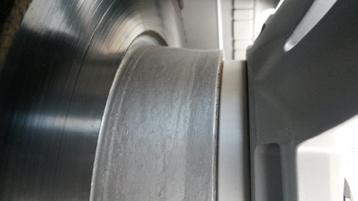

Hello.
I bought some brand new Eibach Pro spacers (S90-9-11-002) from ebay:
- 11mm per wheel
- hubernetic
- 5x112/5x100
- 57.1
...and foud out that the diameter of spacer is about 1cm less then diameter of a hub. So there is a 5mmx11mm gap round and round. Pics are attached.
Could this be an issue?
The seller stated (in his add) that the spacers fit to Skoda Octavia 1U/1Z. Which they do, but i can't find these spacers in Eibach catalogue for my vRS.
Any thoughts?

It's fine like that mate, nothing to worry about.
