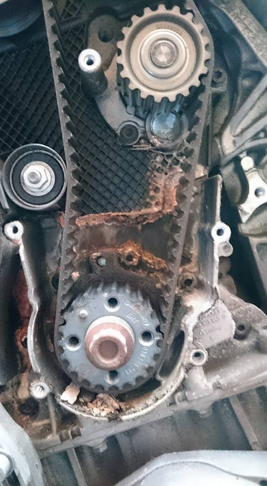

Well, the tank and cap didn't actually fix it, still losing a little between services.
Looks like I found where it is going.  There is a plug on the waterpump which has been leaking and making a right old mess (see the collection of crust at the bottom of the belt cover)
The eagle-eyed out there might also notice the state of my crank bolt.  Some @%^£@ left the dust cap off the damper pulley, and as a consequence the inside of the pulley is nice and rusty, too, had a little bit of fun getting the pulley bolts out.
Not got the car back together yet - thinking about whether I should be getting a new damper pulley or not.
