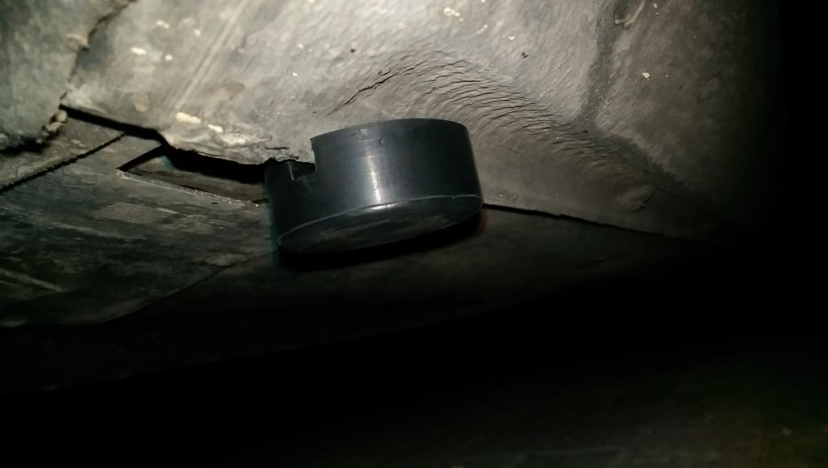

Started jacking up the front of my limited edition earlier and ignoring the fact that my aging £20 halfords jack died before I got going, I want to make sure Ive picked my jacking point well.
I used the point behind the sill with a bit of wood after I'd removed the plastic trim around said point.
What's everyone's thoughts on the PIC?

Cheers Mike. I'd actually ordered a hockey puck thing, but I think the snow in Sheffield has delayed it! I used the inner of the sill because that bit looks the strongest and the profile of the widow maker jack claw suggests that the outer part is used to prevent slipping only, thus the inner takes all the weight.
I know this isn't specified in the manual, but I jack mine up at the point where the suspension attaches to the body- the rear ali bracket on the front and the steel housing not far from the jacking point on the rear. If the car is designed to be supported at that point during normal driving then it seems sense to me to use that as a jacking point if you gave a suitable trolly jack. Obviously if you're using the scissor effort you can't do this.

That jacking point with the wood is a "no" from me.
If I'm just jacking up to change a tyre quickly (no undercar work) I use the console bush like "littleade" does.  You can just see the bolt in the lower left corner of the photo.
Generally, I put a bit of rubber on top of the jack pad & jack up on the sill so that i can use the console bush for the jack stand.

I have used this point to jack when replacing my console bushes. Works perfect as the floor is very strong at this point, and as it looks (from the photo) like you nicked the piece of wood that I used, I know it sits nicely flush with the metal. As you say, remove the plastic shield first(is that what it is for anyway?).
Agree with littleade also, just common sense.

I go under the arrows - give or take an inch or 2.
Or off the actual front cross member (big chunk of rubber seems to stop slippage & distribute the load)
Or off the centre piece of the rear suspension frame (possibly a bit naughty that one but if I break it I'm the only one I can cry to).

Said it on another thread, but the bloke at National (normally a monkey, but this time seemed quite sensible) jacked it up on the very front and rear of the sill with a flat plate. His logic was it's double seamed so it was stronger and wouldn't bend, and when I looked, he was right! Sold me! :D

If Skoda meant the car to be jacked on the seam then they would have designed their jack to do that - but they didn't on the Mk 2 but did for the Mk 3 which has a different sill design.  Jack the car up with the supplied jack at one of the designated jacking points then look under the car along the seam and you will see that the car rests on the jack immediately behind the seam,   If you use a hockey puck then the weight is taken on the seam.
