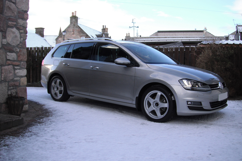

Having got a MK7 Golf & two sets of Team dynamic alloys..............defo 28mm long taper M14 x 1.5
However...................some of there alloys require slim "tuner" style bolts as the pockets are too narrow for standard 17mm head bolts...............
....also be aware that ceratin plastic spigot rings will not fit the hub properly& the wheel will drop 1mm behind the "olive/rib" on the hub flange.....................the spigot rings need to be 10mm thick/deep on the inside edge closest to the hub flange (on the 57.1mm bore side)..............
