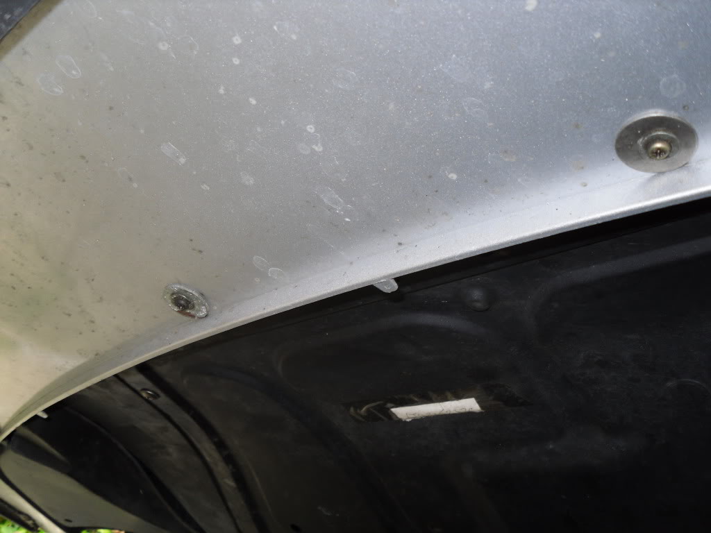

no pics of my own but this is a pic of where mine hangs down from
under the radiator

Ok, you need tx25s vag body trim/arch screws (ebay). And there should be holes up there somewhere. Could be worth undoing the pair of bolts under both ends of the rub strip and just making sure it's aligned ad mentioned above. May make lining it up with the holes you need for your screws easier. The centre section of the undertray should be there as well, is that still present? I suppose it's possible that if the bumper has been caught alot in the past the heads of the tx25 could have been knocked off if corroded, leaving the thread in there which is why it doesn't feel like there's holes present. Have a good look where the holes should be, push up the loose flap and see if anything appears in line.
Oh, that's the engine undertray, not the front bumper. :)
Yeah if it's the undertray flapping round there are slots in the bottom of the valence for it to push back into, tabs on tray should clip back in unless too damaged.

Well its lined fine as its done by myself when i fitted the slam and rad pack i got from u :angel: dont seem to be any undertrays undermine the underside fo the bumper the yellow part on mine is what catches its defos not the undertrays and ive tried a few times over but dont have anything to screw into theres just a cable tie on one side that goes into a whole drilled into the underside of the slam panel

Pretty sure that section of the bumper had tx25s that screw into clips on the tray, so you need the tray for integrity of structure. Loads of tray centre sections on ebay and fitting kits (packs of screws with clips). Screw sets about £8 and centre tray £20+ if you're without the centre tray the side sections are lacking support. Are they still there?

That's decent news, centre undertray and fitting kit required, putting it on should solve your speed bump problem. Might be that it only pulls it up by a bit if it's been off for a while, but hopefully enough. Tray is useful for splash protection and airflow under car so needs putting back on. Side sections may fall down eventually as happened on my Seat after leaving my centre tray in a field.
